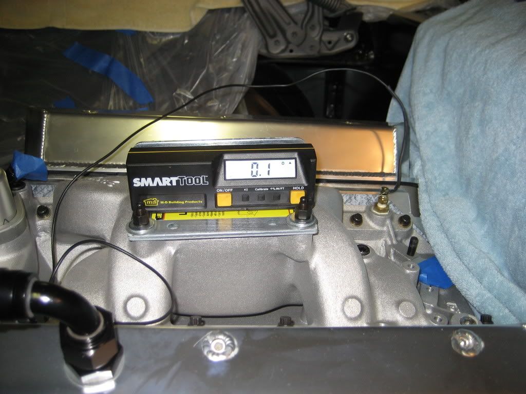

After alot of research I found out that I had 1969 307 frame stands and 1967-1968 small block engine mounts. They changed the motor mounts in 1969 for the low performance small blocks. I couldn't have had a taller set up. I do have to thank Dan Lemons for that one. I am going to email him so he can update his records. I figured out that going to 1969 HI Po 302/350 mounts gained me 3/8 of an inch. They used them to gain hood clearance for the cowl induction option. On the left you will see my new set up that gains me 3/8 which equals about .2-.3 in driveline angle but it made just enough difference. The aircleaner clearance is a bonus.

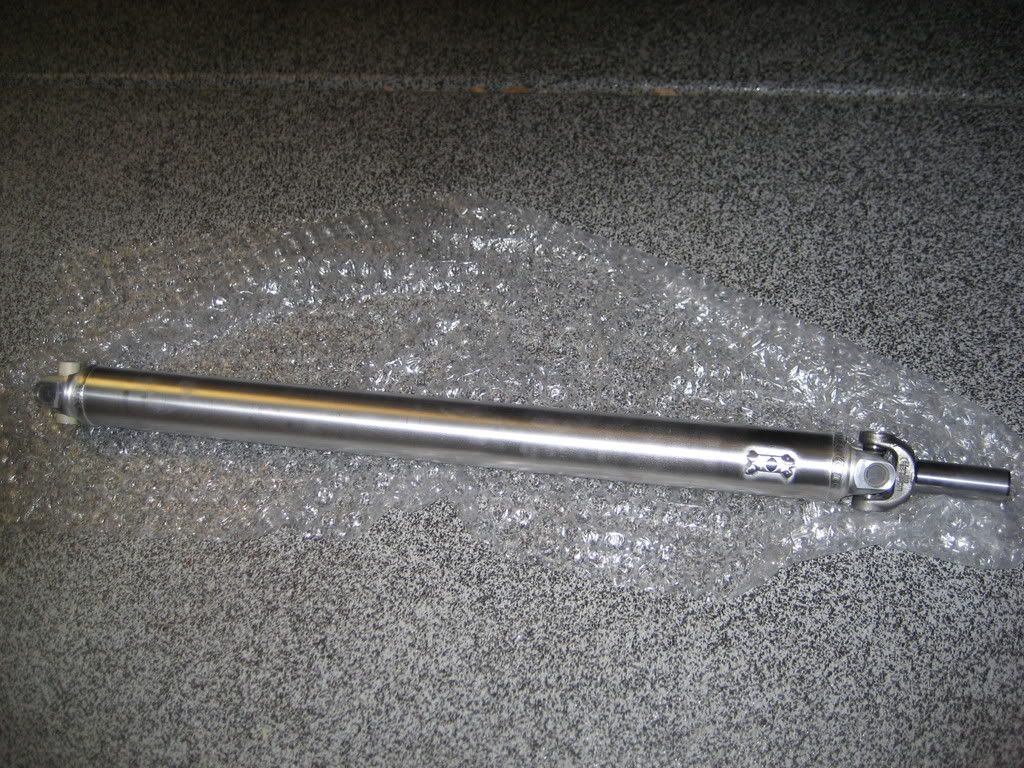

My new driveshaft showed up today from Empire Driveline and Classic Chevy. What a nice piece!!! Will insall and measure working angles on my =driveshaft tomorrow hopefully. If that all checks out Tyler at ATS will be getting a call to fab my crossmember finally!

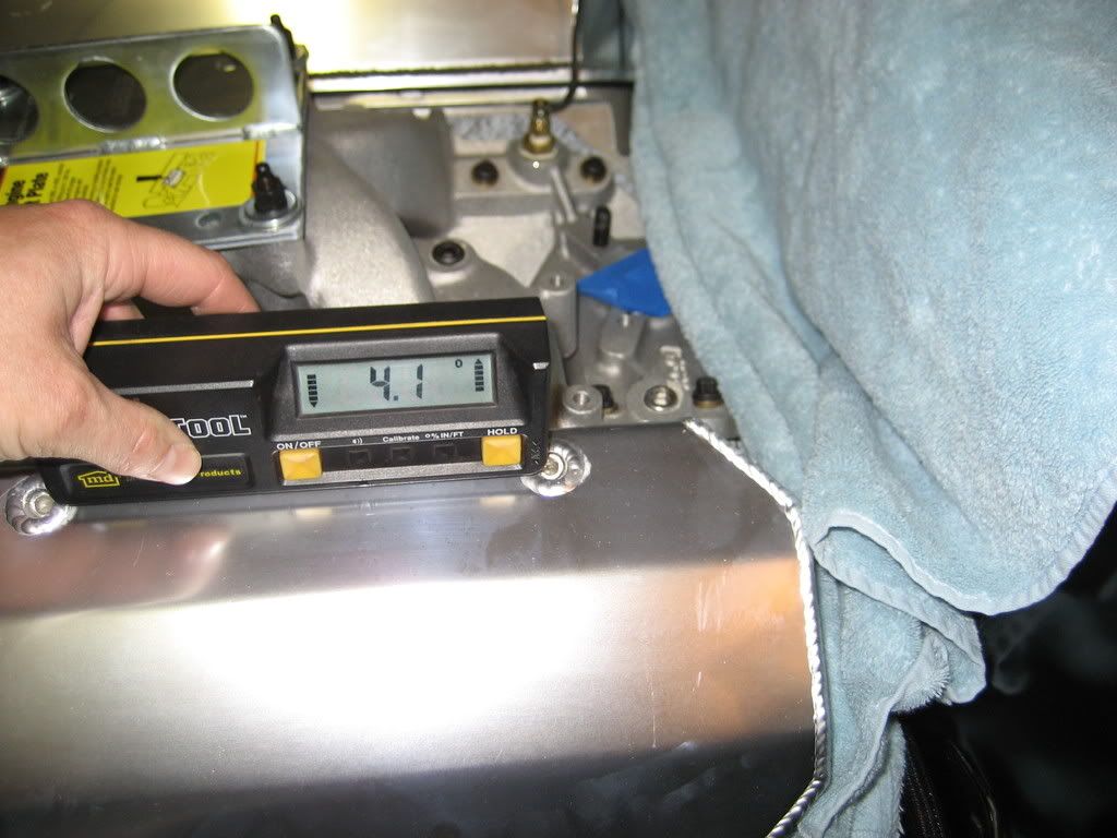

With the tranny not touching the tunnel and the vent as close as possible with no compression the intake is at .1 degree and the driveline angle is 4.1 down. I found that the valve cover crease is equal to the tail shaft angle. The car does pitch down in the front slightly stance wise so I will more than likely gain a little and the car the intake will probably end up perfect along with the drivettrain angle. I am probably going to build some blocks to put the weight on the front wheels to get it at true ride height and compress the rear end fully to do my final drivetrain/driveshaft angles. Things look pretty good now...I can probably tweek the cross member with shims just enough to make it work and be in spec with no vibrations or unwanted noises. Time will tell.

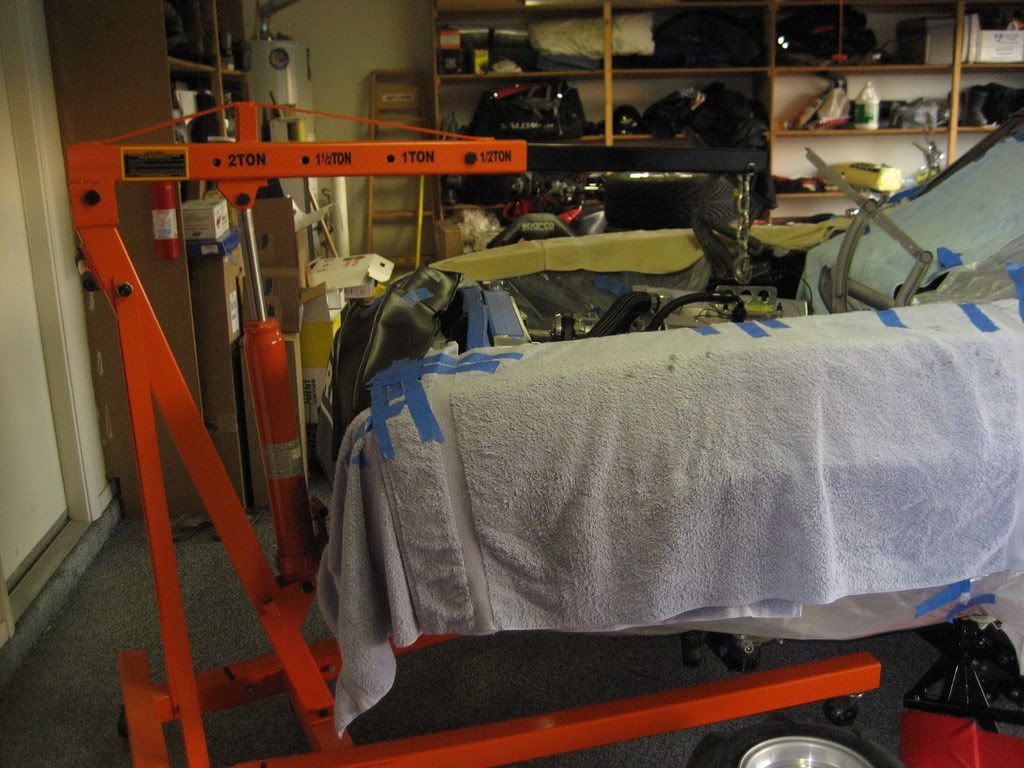

To achieve the measurments I leveled the car using the rockers.
