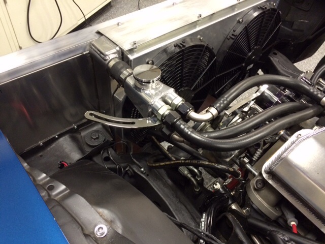

Finally got the radiator mounted up

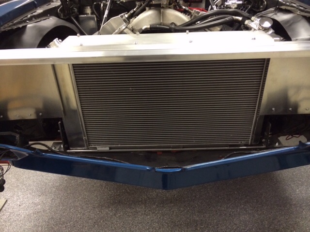

Rear view

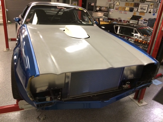

Now I need to mod the hood as the back of it hits
the top of the firewall.. guess those lowered frame spacers
I put in years back lowered things just enough to cause more work
Bob

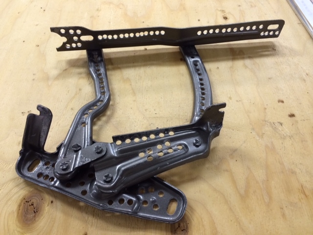

Doing a little more to reduce weight as the alum
hinges seem too costly for me

I've done things like that in the past.
Did you weight the difference ?
Since my car was fully caged I started hole sawing all the internal roof unibody parts. AFter my 3rd or 4th hole cut, I took out the calculator and figured out how much weight I was saving, after all I was cutting out 20+ 2.5" holes.
I'd spent 20 minutes cutting the first 4 holes. I figured if I cut all 20 it would save - 1.1 lbs.
I put the hole saw away.
  #260
