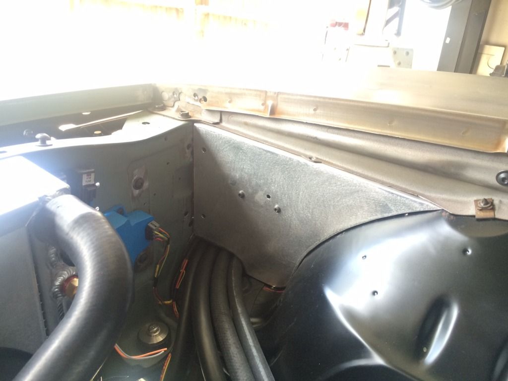

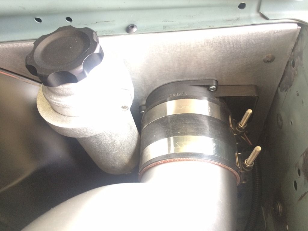

Wayne . Yes I made everything from the throttle body to air filter.. Thinking of making a few complete sets ( all HPS clamps, silicones, air stack ,hardware, gaskets etcc ) ready to bolt on. It will only need to weld two tabs and drill a 1/4 hole on fender as seen on pic. Just waiting to actually try it with MAF in that location, will be using air straightner at the stack in hopes it will enough to get accurate air readings.
Also made a matching passenger side , using to clamp the hoses and hide the AC dryer.

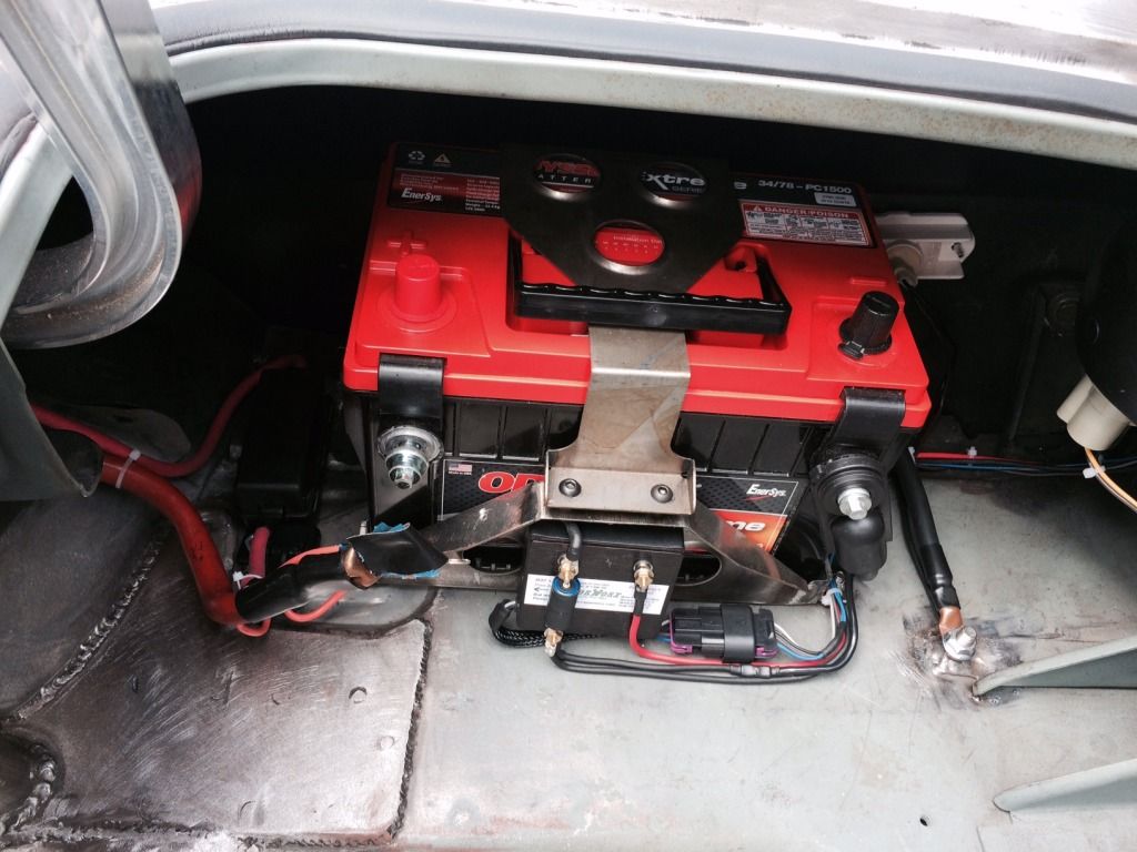

battery is in , every connection is crimpped and soldered , wiring is finally done. still nipping and tucking
right hand man walking the job .

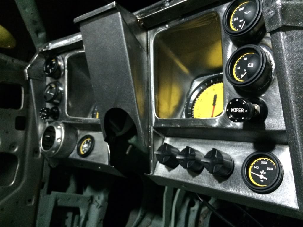

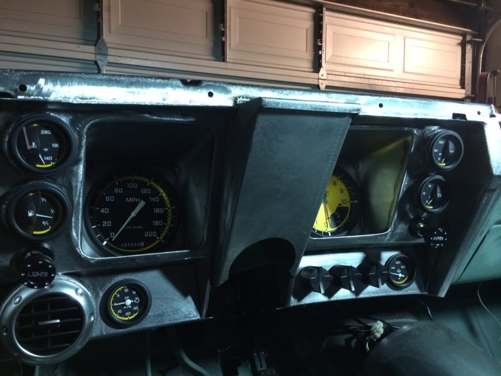

where did ya get wiper and lights switches?? looked all over
[QUOTE=frankv11;535323]tx
Originally Posted by Ron in SoCal View Post
Way to go Frank. That dash looks like a lotta work!
quite a bit of work. what made it most difficult was the horizontal radius and the dash face is slanted in about 15* so I had to make a separate bezel for every gauge (except bottom row) to bring them back to 90*. left a bit of space on left side for pushbutton start. so yeah its been fun but that is exactly the look I was going for. i wanted the dash to have some dept. not a fan of the flat. very happy with the outcome thus far.
I actually went through photo bucket using iphone( copy and paste as usual )not directly from iPhone but I was not able to do it either way in the past.
pictures of where I'm at now.
