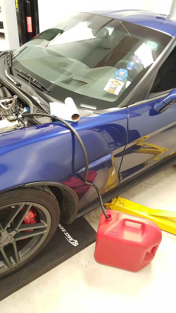

So todays project was just to empty the tank - well that escalated into getting the car in the air, taking apart the fender/wheel well to get to the tank, then dropping the tank!
Of course the return line inside the tank snapped when I got the crossover tube disconnected - so I'm on hold until the replacement parts come in from Amazon.

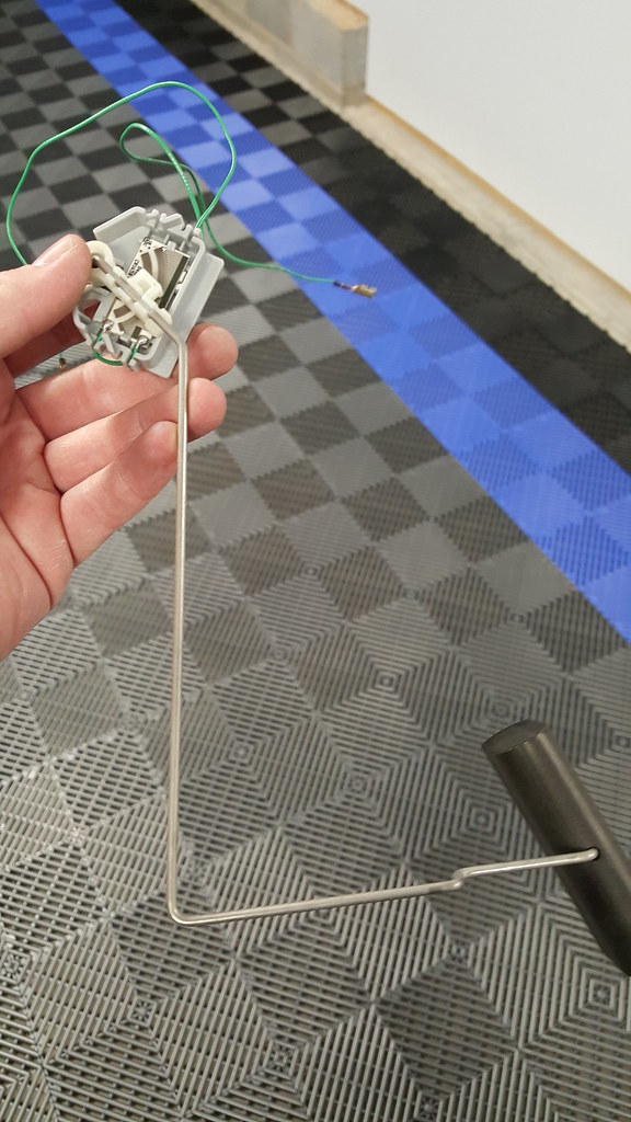

Quick update - my fuel lines for the Corvette finally came in - so I tore the gas tank apart to swap out the fuel pump for the Z06 pump - and the new lines. I got everything apart and noticed that my fuel level sensor was messed up. It had a exposed wire on the bottom of the sensor - and the contacts are also bent the wrong way.
So I ordered a new one - and get to play the parts waiting game again.
Looking at the new sensor design - they flipped the wire contact points to the top. If I had not discovered this issue - it for sure would have caused me an issue in the future.

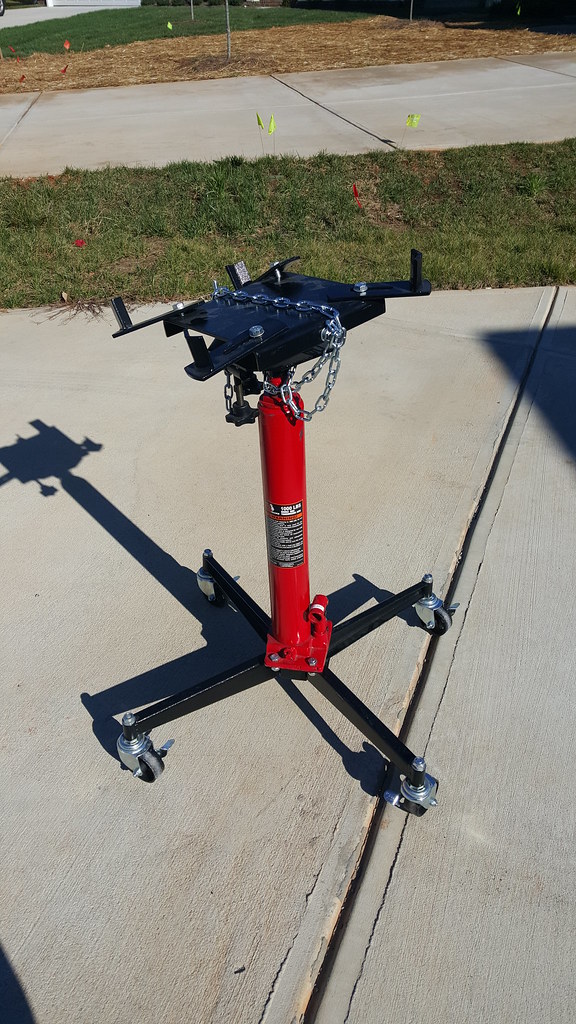

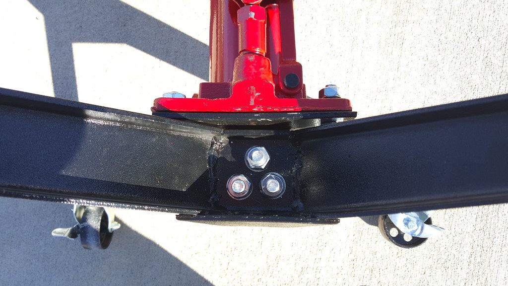

So I had some free time today - so I decided to finally modify my Trans Jack - I might use it to get the gas tank back into the Vette.
This started off as the Torin 1K Lb transmission jack that I got from Northern Tool.
I cut the bottom of the stand off - and drilled the three holds for the leg mounts - and finished up this project.

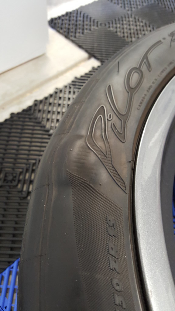

A few weeks ago I had noticed that the rear tire was leaking air - so I took the car to Discount Tire to check for a nail - they didn't find anything. They noticed there was some corrosion on the inside bead of the rim - they scraped it off and put some black sealant on there to make sure it held air. Fast forward to today - I took the wheel off the car to take it over to the shop - and have them check it again - and I discovered this:
So now I have a ballooned sidewall - and maybe a leaking rim... awesome!
Glad my really expensive 345 tire is now junk - I wasn't really planning on buying new rear tires just yet - now looks like I have to add those to my list as well!

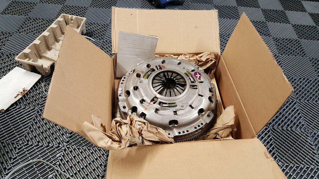

So my fuel project turned into a big cluster bomb - and I'm going to have to drop the drivetrain down to get full access to it.
So since I am going to have to drop the trans and torque tube - I decided to order a clutch and replace the stock LS2 unit while its apart.
I picked up a new LS7 clutch for a really good price - and it should hold my power with no problem.
I have driven a few LS7 Z06's and I really like the engagement - way different than my LS2.

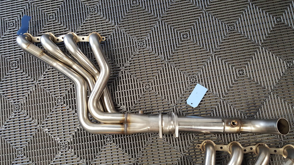

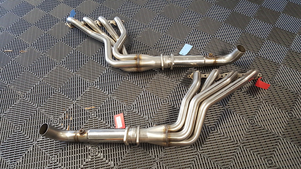

Also while I was clutch shopping - I happened to look on Amazon for a set of Kooks long tubes for the SS - I had been watching the price for awhile and the dropped from $800 - to 700. 600, then dropped to $571 - so I picked up a set since they where ridiculously cheap.
Those came in as well - I am a long ways away from installing those - but at that price I couldn't pass them up.

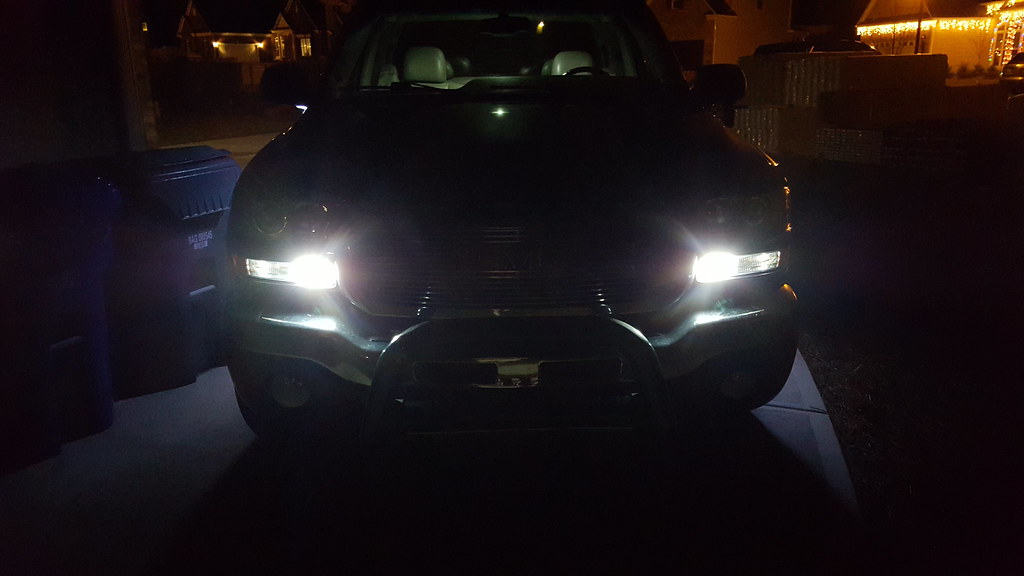

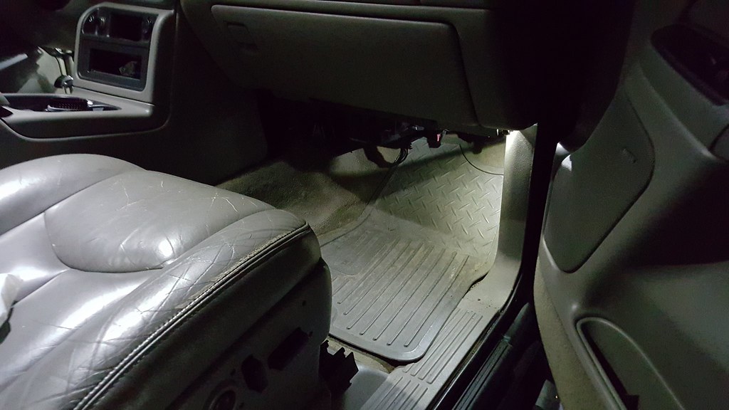

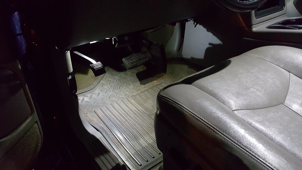

Awhile back - I replaced all of the outside halogen bulbs with LED's.
Today I finished up the lighting upgrade by adding in the footwell 194 lights - and installed LED's in there as well. Overall the footwell lighting was fairly easy - soldering, heat shrink tubing all the wires up is what took the longest.

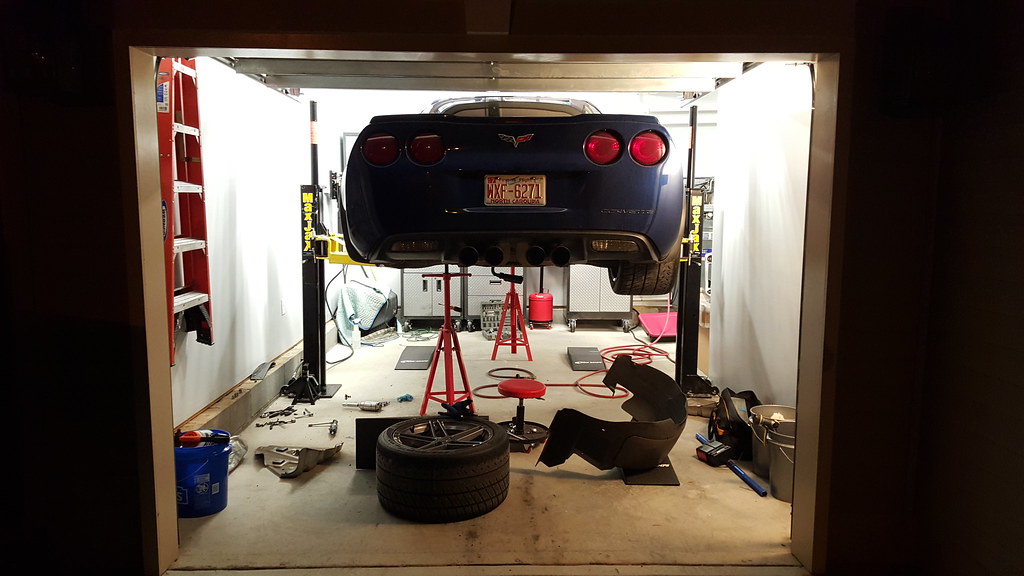

So I started on my clutch install tonight - I got a few parts off of the car.
I got the rear splash guards out, the rear wheels off, and the exhaust is off - from the headers back.
Next will be the torque tube plate, probably one of the headers, and then it will be rear subframe/diff/trans/torque tube - and I should get access to the clutch.
I'm not sure when I'll get to the clutch -as the holidays are coming up and shop time will be limited.
This pile is just starting to grow:
