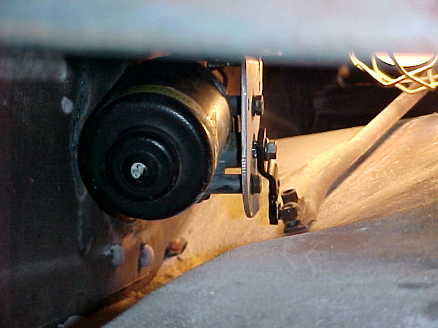

Oops, nevermind. I just read it in the description. I'd like to see pictures of that hidden wiper motor though.

Originally Posted by trapin
I have a question for Chris. Where is the wiper motor on that car? I see you have windshield wipers but no visible wiper motor. Did you get creative in hiding it or are the wipers static?
Great looking car, BTW. I've been following your story for about 3 years now, even before you came to this site.
THanks man! The wiper is a 85 VW on a custom bracket mounted to the stock wiper transmission assembly in the cowl. I got the idea from a post I saw at PT.com, and went from there. It can be wired to work with your stock switch, or in my case I wired it through a column mount later model style GM switch and saved the spot on my i/p where the stock switch went for a fuel pressure gauge.
