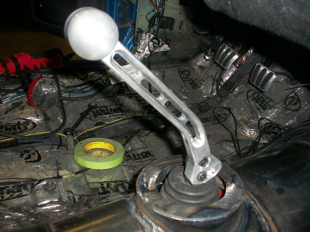

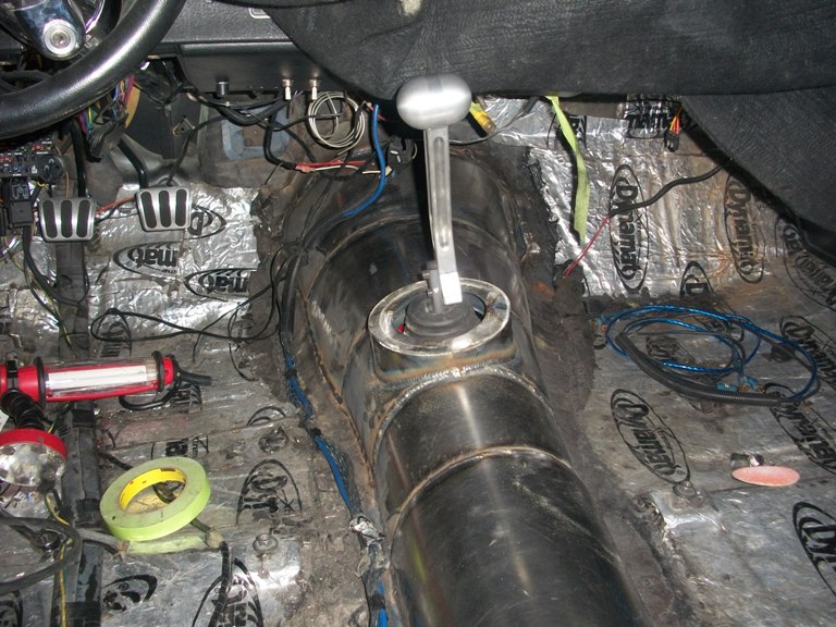

The transforrmation is coming along. Here are few pics of the tranny tunnel getting fabbed & modified for the T56 Magnum and driveshaft. Next, is to finish up shaving the firewall and get it painted.

A few more after test fitting the shifter handle and welding up the shifter ring.

Funny -- I was designing this same tunnel "mod" around the TKO 600 in my buddies 55... But since it has an Art Morrison chassis -- and there's NO WAY to get the tranny out of the car without pulling the motor... I wanted to be able to "service" the shifter from the top.... so went with a "flat" piece that I can remove and be able to get the whole shift mechanism out. That and he already bought a "factory" precut carpet...
