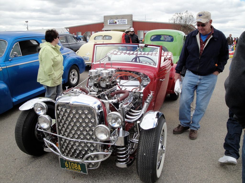

Well --
Finally got the full color rendering for the final design including all of the tweaks and design changes.

I bet they are a blast to cruise. I agree with Dave. Keep the T56 and just don't use 6th gear. Isn't 5th in a t56 a reasonable overdrive?
Todd
  #30
Old 09-26-2010, 05:52 PM
Todd --
Like most things - there's more to it than just "leave it in and not use it"... I'm having the motor set back from where it is. Since the shifter position is already really crappy -- right next to the seat - which makes a very awkward shifter position and the throw is just all wrong.... It would be into the seat frame once the setback is changed. The TKO 600 allows me to move the shifter to a proper location. So the change, fixes more than just the gearing issue.
80 in one of these -- just isn't something you're going to do much of. Trust me. These drive way different than a 69 Camaro. I don't like my Nomad UNTIL I'm hitting 75 plus... but in a roadster -- 80 is just beating the stuffing out of you. 70 feels like you're flying... It's more like being in a Go Kart.
