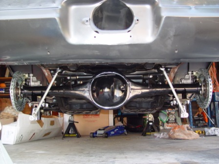

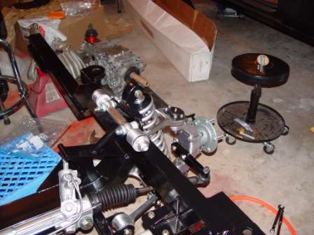

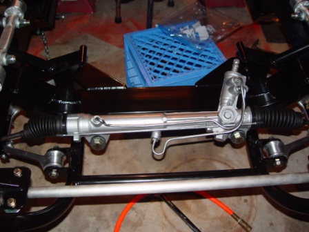

Default Progress photos as of July 8, 2006 (message 1 of 2)

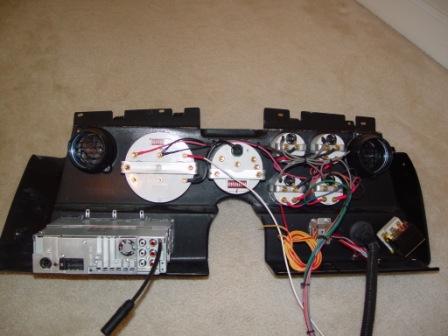

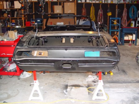

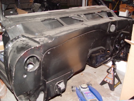

All,
Here are the progress photos I promised. There are more in the next thread.
Your feedback is appreciated!

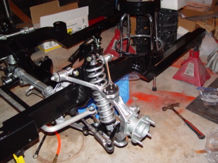

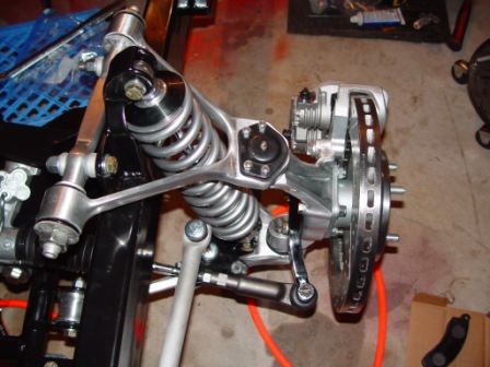

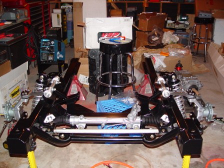

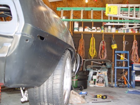

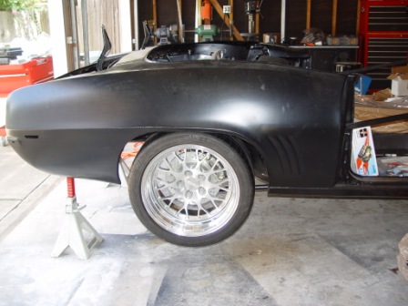

Default Progress photos as of July 8, 2006 (Message 2 of 2)
Remaining pics.

Thank you for the encouraging words. As you know very well, I have a long road ahead. However it will be fun (mostly). If my body had come from CARS, I would have picked up the phone by now and demanded a discussion with Steve. However, since it did not I will have to take the wait and see attitude with my Dynacorn body.
An issue I countered is that the rear frame rails are not centered. I know this is common on original Cars, but I really expected better from the new bodies. Then again, why should I expect a small shop to do better than GM. Additionally, after closer inspection since reading Cris' post on Camaro's I discovered that the passenger side quarter is not aligned well with the B pillar. As far as the rails are concerned, I centered the rear end to the car, which put the coilovers at different distances from the upper mounts. I will need to cut one of the shock mounts off of the Air Ride bracket and relocate it to get symetrical shock angles and a level rear end. I will find the culprit with the passenger side quarter when I get the doors on. However, I am afraid it will not be pretty. This will definitely put my paint and body budget of $8K somewhere higher. Who knows what else I or the body shop will find. So, budget, schmudget. Right??
Thanks,
BT

That has been (and still appears to be) the biggest issue with these bodies. Fit and finish will require a lot of metalwork to get it right.
Good luck and thanks for keeping us updated.

PThibodeax:
Looking at your pictures, you might have some issues with your rear tires rubbing.
Hopefully I am wrong.
Your build looks like a lot of fun.

Default Rear tire clearance
Ty,
I purposely pused them out as far as I could. They may look a little too far out due to the camera angle, however they do clear all the way through suspension travel.
Thanks,
BT
