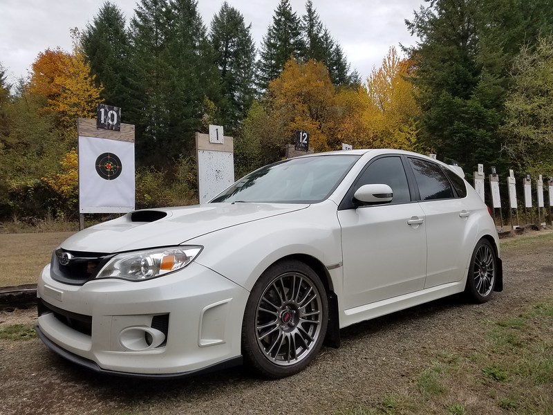

Congrats on the invite!
Great choice for a daily driver, I've had a similar platform for two years now and absolutely love it.
DD shootout?
