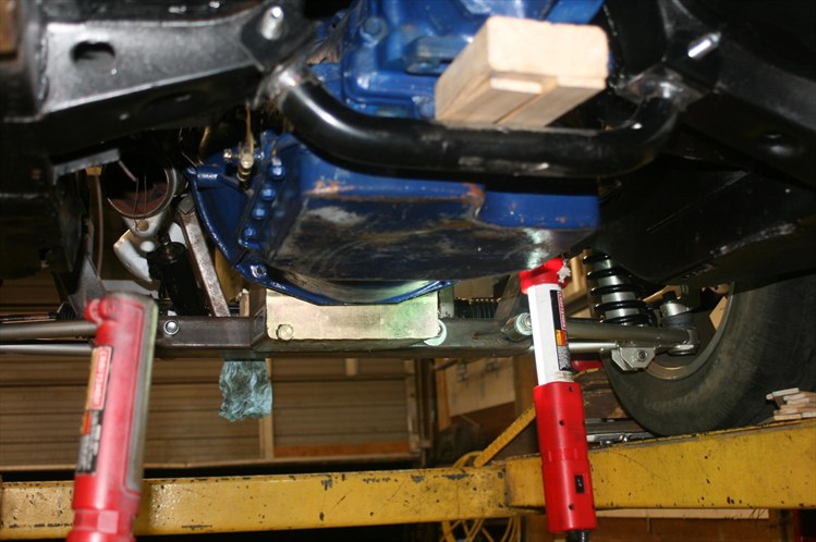

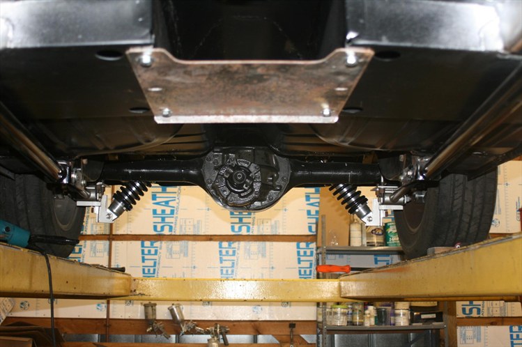

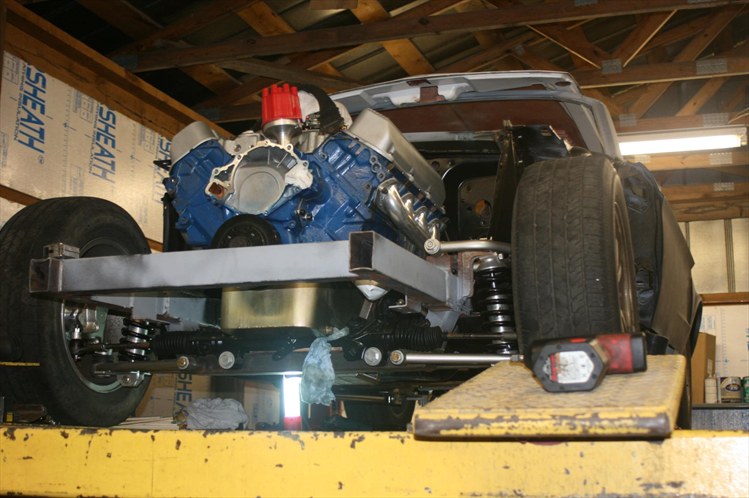

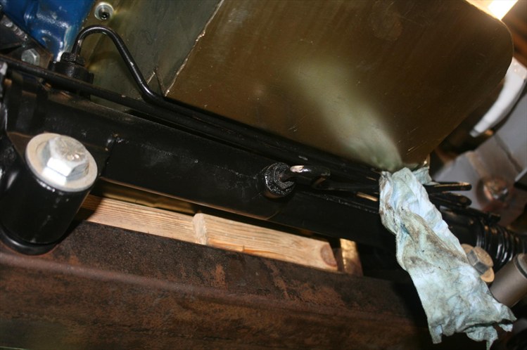

We installed the TCP subframe connectors / x-frame, had to tweak the rear setup, and the engine / trans should be going in next.

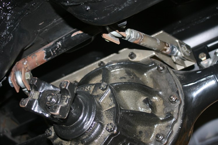

My neighbor Chris as been helping me fix all the mistake that ### Racing made when they were working on the car and they made a bunch!
* Mounted the subframe connecters - things were a little off as happened with old cars - Chris got it looking good. He welded the frame up real nice.
* Had to remove the upper brackets on the rear suspenion - the previous guy welded in the front bar about 2" off to the drivers side; making the rear off to that side too. We cut the old brackets and welded in new ones. Also the previous idiot welded the rear sway bars brackets in backwards. We had to cut the old ones out and weld in new ones.
* Making a new transmission bracket.
* Getting the engine mounts in place and the steering system completed.
