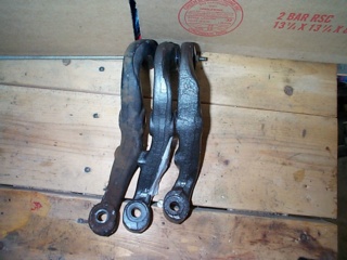

three different lengths of outer steering arms???????
explain please ithought there were only a body and camaro
one each
one each
Read more here: http://www.pozziracing.com/camaro_st...part%20numbers

Originally Posted by David Pozzi View Post
Wow that is super informative info, Do you know a place to find the short arms? Or is that like a needle in a hay stack kinda deal. I have long ones I need to change for wheels clearance issues. What length are the typical replacements you can buy?

Are these listed wrong due to the number he is posting and the steering stops? Maybe off an early nova

Those ebay arms look like the long ones.
sometimes you can find them on ebay or at swap meets, any of these GM cars like Nova, Ventura, Omega, 71 - 74 will fit, it's the same subframe.
CPP is making replacements but they duplicated the LONG arms!

Thanks you answered my question, I need a set of shorties to clear the wheels on Rich's camaro
