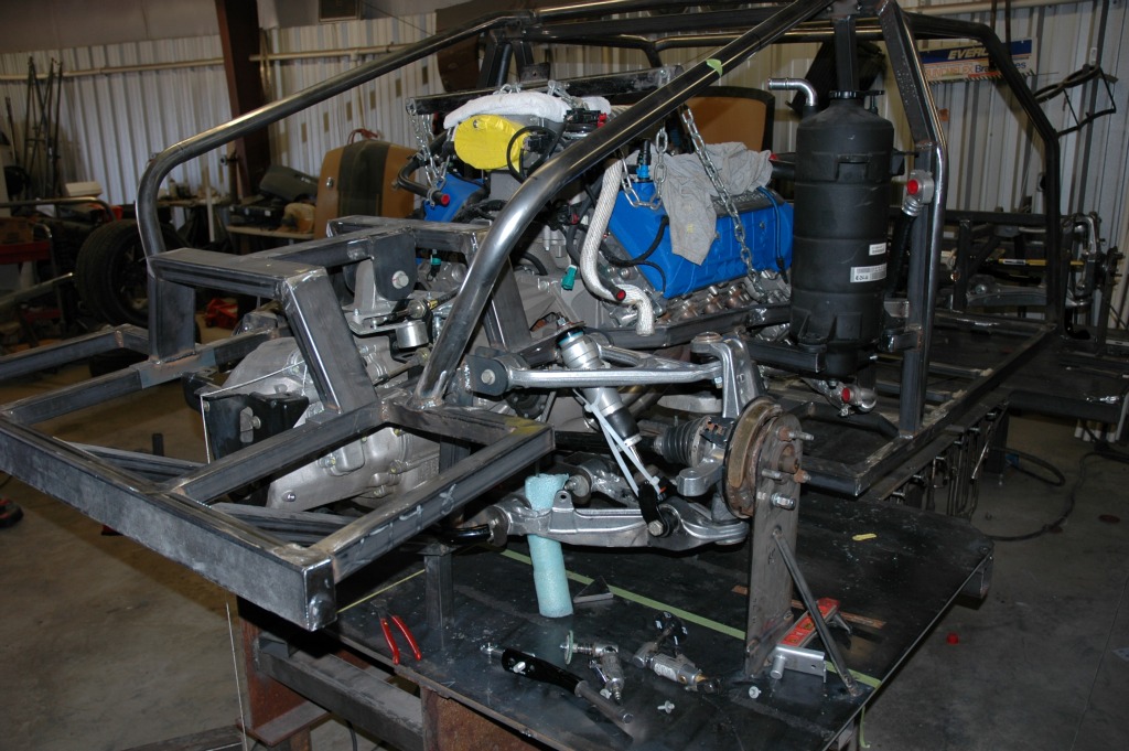

Well it's on the jig.

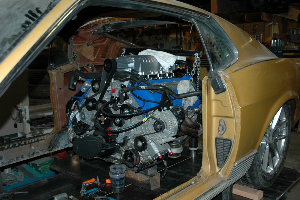

nice engine, thats going to be a visceral ride

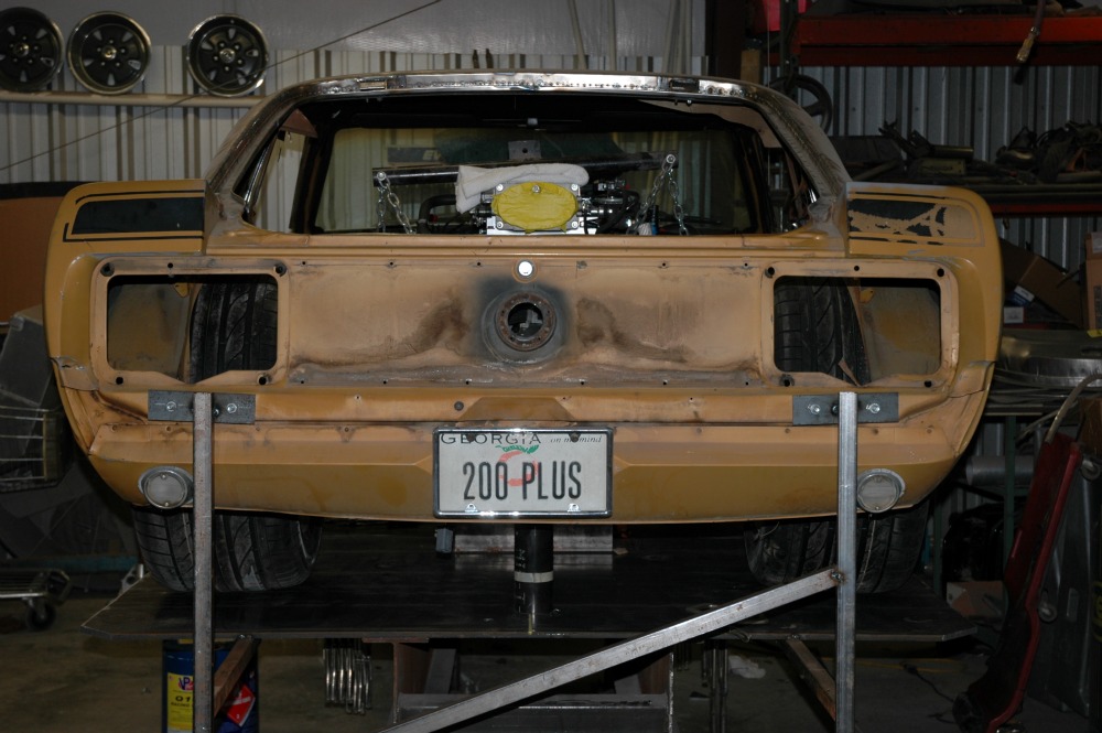

Bob, are you going to have enough room in the passenger compartment to fit comfortably? I'm not familiar enough with mustangs to know how much room they have inside. I figure it's going to be tight no matter what.
That's what I was thinking also, gonna be t-i-g-h-t. You could always look at pushing the rear wheel openings back? Not sure how much overhang there is on the rear of the transaxle? Most folks probably wouldnt even catch a 6-8 maybe 10 inch rear shift in the wheel opening.

Is that a GT drivetrain?

Originally Posted by REAL BOB JOHNSON View Post
I'm using motor and trans axle out of a 2006 ford gt with 4000 miles. The suspension will be c-6 corvette. Haven't picked out wheels yet, Bob

more pics of progress. Most of the chassie is done and as far as room it has as much or more than my camaro. I've moved the wheel bace 2 inchs for the extra room
