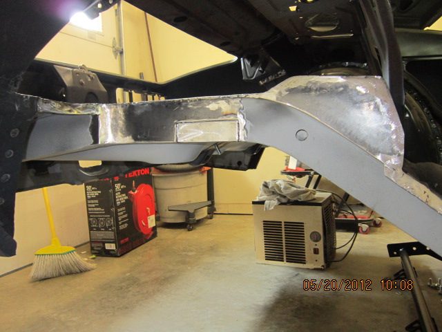

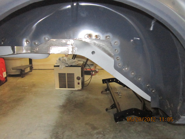

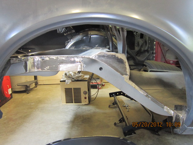

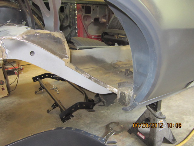

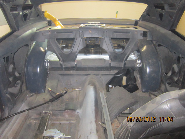

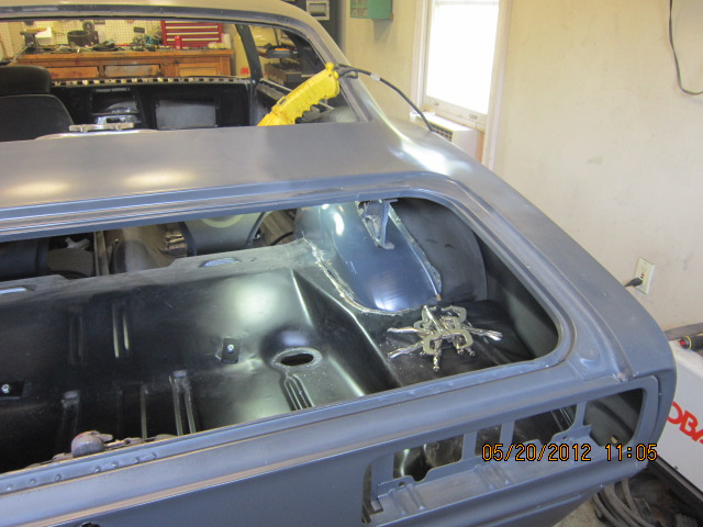

Pictures from installing the passenger mini tub. Tubs are now basically complete
