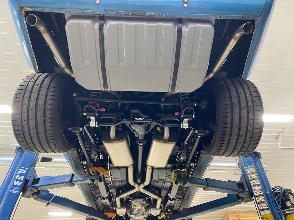

My full old man exhaust system. I’m tired of loud cars. I’m using a used set of 2018 Corvette Z06 LT4 catalytic converters and a AP muffler.
Hooker cast iron exhaust manifolds and 2.5 inch exhaust.
Looks great and has plenty of ground clearance. What resonators and mufflers are you using in that system?

Originally Posted by OLDFLM View Post
Part numbers for the AP mufflers Mark?
https://www.rockauto.com/en/parts/ap...uffler,1001311

Is the reason you are not using flex joints at the beginning of the pipe that it’s a cast iron manifold and not headers? or have you learned they are not required? Thank you
We were planning to use flex joints but did not have room. I’ve never used them but never had an issue.

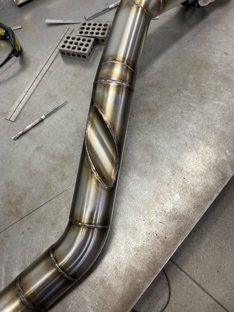

Old 08-27-2024, 06:49 PM
Stielow's Avatar
Stielow Stielow is offline
Posts: 2,523
Thanks: 29
Thanked 2,296 Times in 619 Posts
Stielow Engineering
The Following 3 Users Say Thank You to Stielow For This Useful Post:
camcojb (08-27-2024), fleetus macmullitz (08-27-2024), Roger M (08-28-2024)
Old 08-27-2024, 07:24 PM
jeff71 jeff71 is offline
Join Date: Aug 2007
Posts: 406
Thanks: 4
Thanked 74 Times in 49 Posts
Looks great Mark. What’s the clearance for on the pipe? Can you post a vid of it running.
The Following User Says Thank You to jeff71 For This Useful Post:
Beautiful work, but not fond of that
Old 08-28-2024, 06:19 AM
Stielow's Avatar
Posts: 2,523
Thanks: 29
It is a cruiser and I don’t want a tail pipe rattle. In hindsight we should have notched the trunk floor like the other builds. This is the first car in 20 years I have not done that. Now I remember why we cut the trunk floor for exhaust clearnce for cars with a Quadra Link DSE rear suspension.
If it is a problem we will cut the trunk floor and redo the tail pipes.
