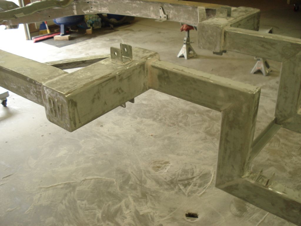

Great project..... and super nice work!

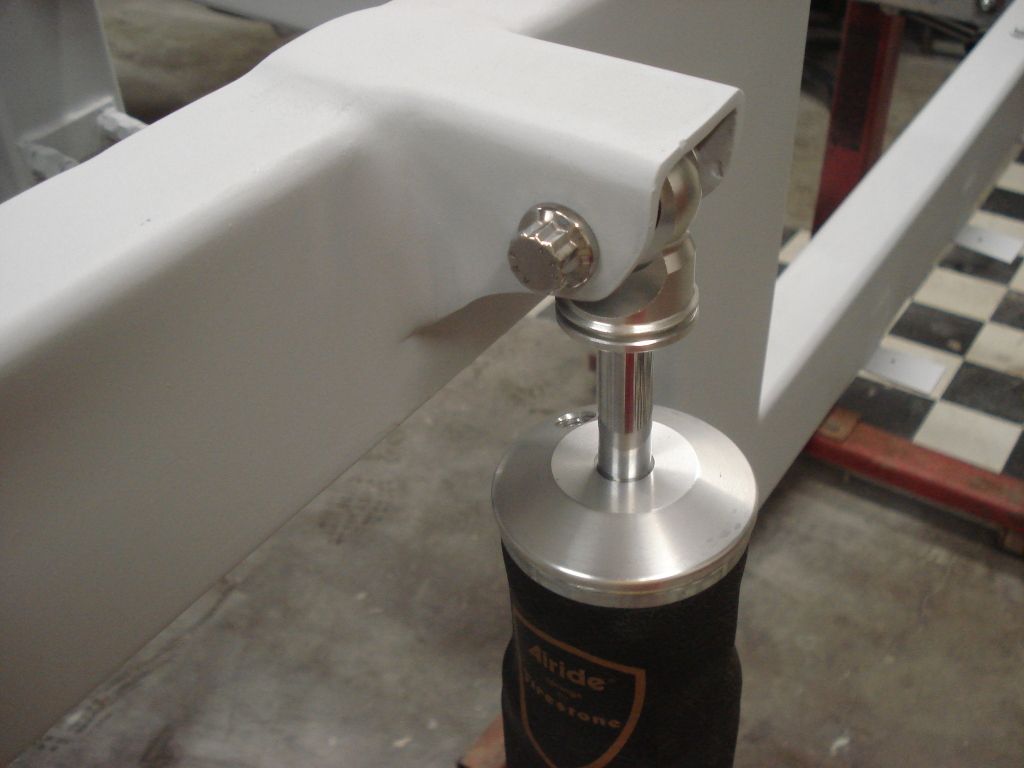

I sure would have liked to have seen some gussets on that rear back half to frame connection point though. That's a lot of tire and motion going on for two boxed welds to hold. Just sayin'...

I see a gusset (triangulation) coming from the area of the four bar attachment out to the perimeter frame? Isn't that where most of the load/force is?

I'm not a suspension or chassis guy --- and I see the gusset you refer to.... but I'm thinking there's a lot of load on the 2X4 chassis where it's narrowed and attaches to the main frame. Only thing holding that entire back half ---- the weld to the main frame - and that's also it's narrowest point. May be that it's just perfectly "more than adequate".... I don't know.

I agree, most frames built like this are tied into a very extensive cage network. Rotation is going to twist the rear section quite a bit.

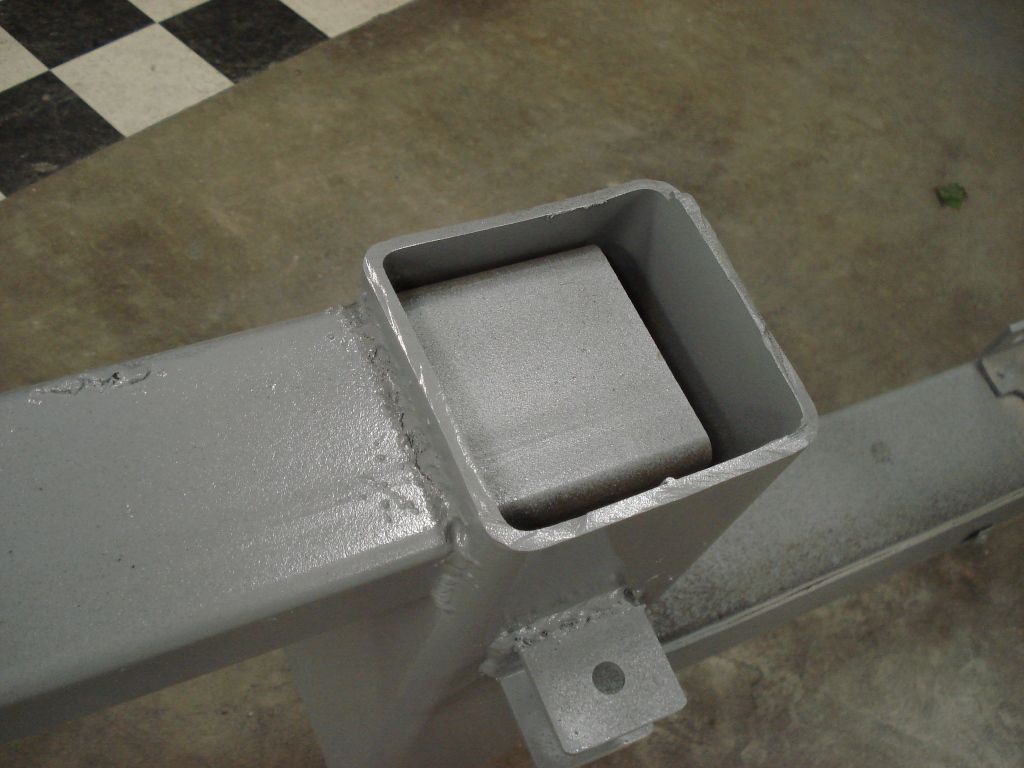

As for the frame what was done is the orginal main rails of the frame actually going into the rear boxed area of the frame and are welded inside and out to really tie it together and used a strong v shaped gusset to tie together as you see and then I welded up the end caps to finish the boxed look to the frame and even added a number 48 from an old liscense plate to give it a lil style lol

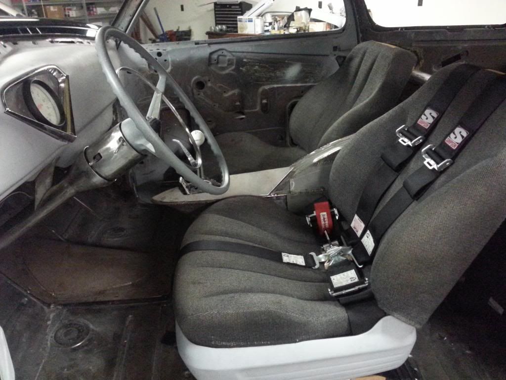

And a quick peek at the interior mock up....

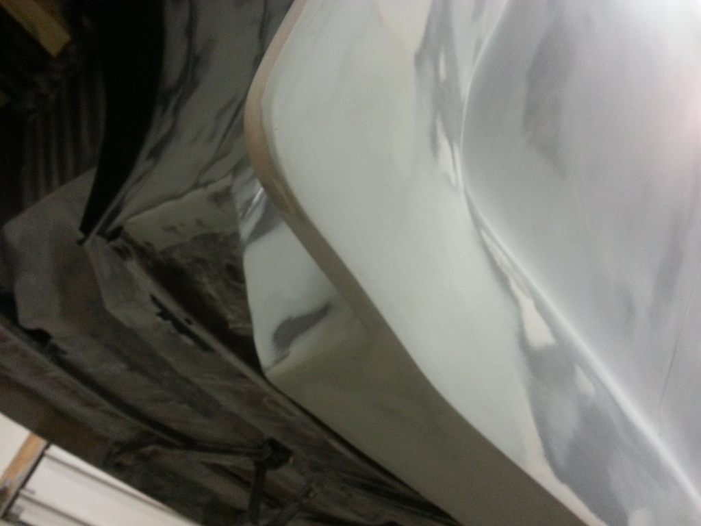

YES working on smoothing up the entire bottom of the car and decided to do it body color!
