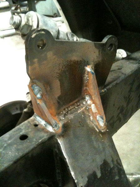

The upper control arm mounts on the D100 are done. This should hold up a lot better now. After talking with the owner today, I will be making some engine mounts so we can do away with the motor plate. The PS pump, alternator and AC compressor were hung from the plate so I'll have to make some new brackets for them.

That's not nearly enough weld bead on there.....

This is just mock up. Nothing is welded together yet.

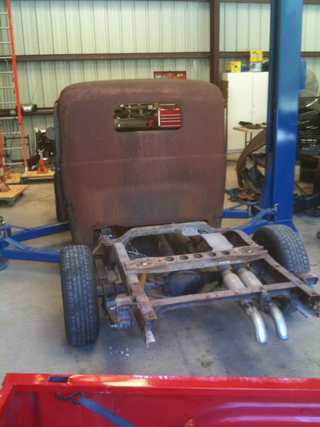

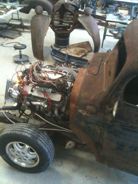

over the last few months there has been some MAJOR changes in the Dakota project, some of which should make it a little more pro-touring oriented by potentially increasing the handling ability. Please keep in mind that this is being done with a tight budget and it's not being done to look like a show piece.
Behold :
Back when I was about 14, I had 1946 Dodge truck that never was on the road. This is a 1941, which is nearly identical. I was thinking of starting from scratch with it, then figured out a better idea. In this picture the wheels are just standing in the wells, there is no suspension or engine in the truck.
stripped Dakota frame
1941 Dodge truck cab on the frame
engine shot before setback

Had to cut out most of the floor and build a new one. It's not finished yet, because I have not finished with mounting the engine & trans.
Originally I set the engine back about 14", but I am going to move it back forward about 4"-5" inches to gain back some room in the cab. The engine set back should help with handling.
Here's how it looks right now. The cab mounts have not been built yet, but the cab is tack welded in place so it can't get bumped out of place. The rear half of the frame will get cut off. I am planing on using 2"x3" or 2"x4" box tube for the back half. Due to the current budget, It will be leaf springs in the back for now.
