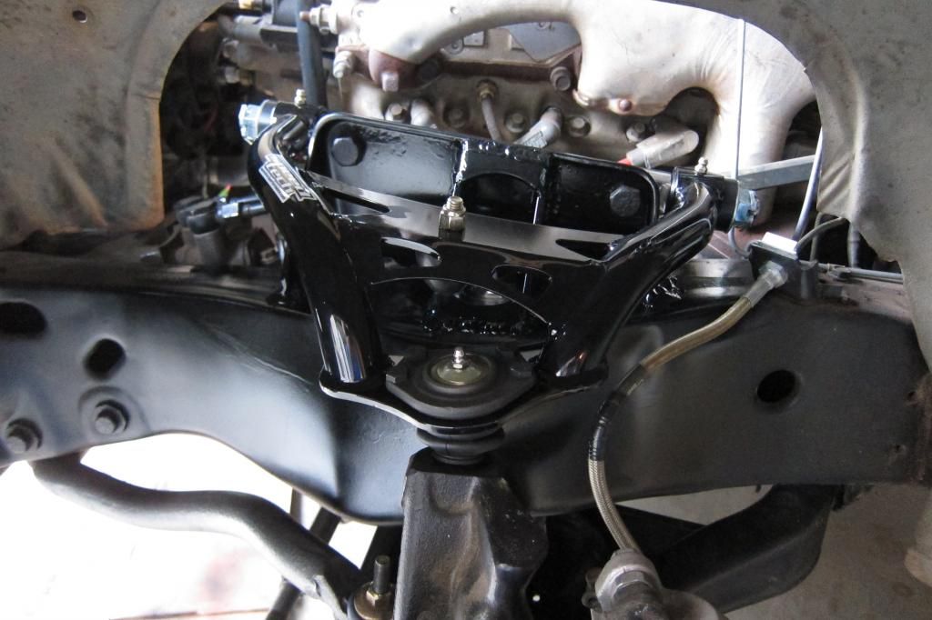

The fun stuff now. I got all my suspension parts from Keith at Custom Works. For the front I have his coil over conversion kit using Viking shocks and 650lb springs. I also put in his front subframe brace that goes under the radiator. I kept the stock LCAs but have gone with Speed Tech UCAs. Not the high clearance ones that require AFX spindles, just the factory replacement ones. I still need to get the front aligned and adjust the coil overs a touch.
I put the same shims I had with the factory arms back on as recommended by Speed Tech. The increased camber at basically the same ride height as before is tremendous. I had the stock arms at about 1* negative. The wheels are pushing 2* negative now. I'm actually a little worried I won't be able to bring the passenger side back out closer to 1/2-1* as Speed Tech recommends because of how few shims I have on that side. I've got my fingers crossed. We'll see what happens. I measured the UCA mounts before and after welding and they didn't move. This was discussed in another thread involving a second gen doing a similar coil over conversion. No idea if that's something that could occur but I measured anyway just to be safe.

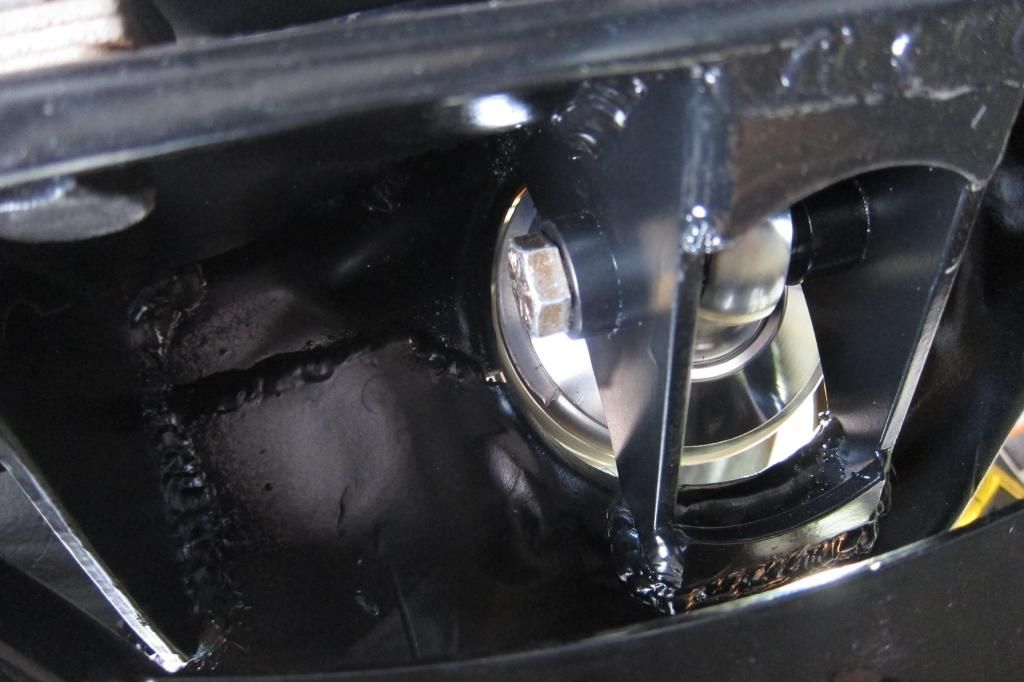

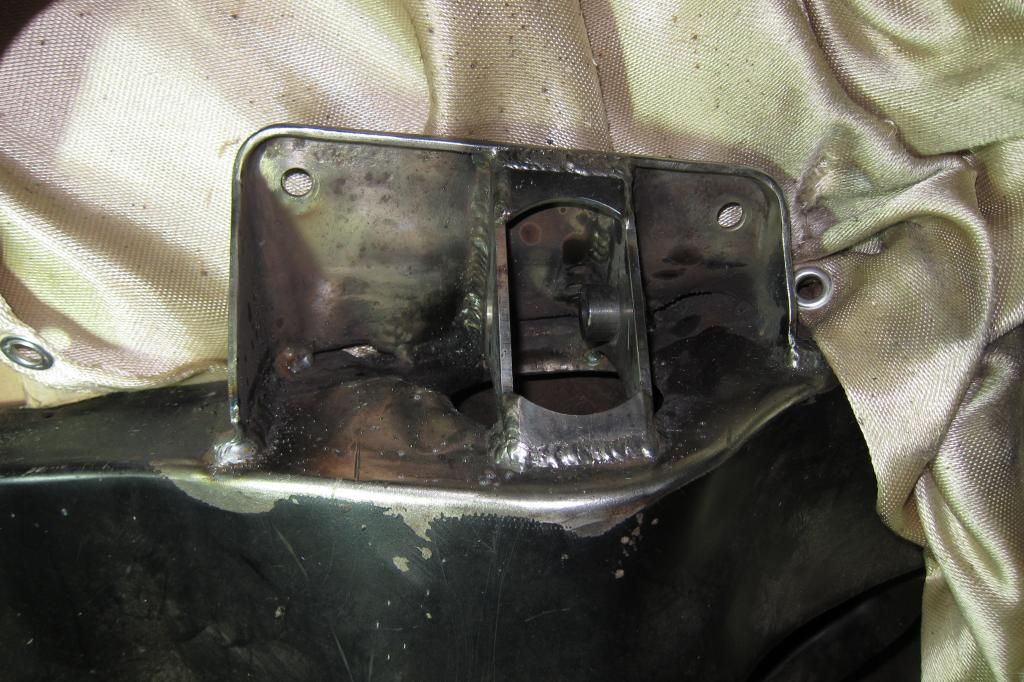

On to the coil over conversion. It was pretty straight forward really. The directions provided weren't bad. Bigger pictures would have been nice but that's ok.
Here's before
With everything cleaned and ready to weld. You'll need to cut out the inside of the spring pocket. I just took a cut off tool and went around the perimeter from the inside. If the tool uses 3" cutoff wheels, it should fit. I would also recommend only cutting the top of the UCA mount far enough back from the folded over portion that it leaves a straight edge. That way you have more of a lip remaining to weld to. The directions say 3/8" is what should be left and I don't feel that's enough.
Mocked up and checking for fit and clearances before final welding.
All welded in place.

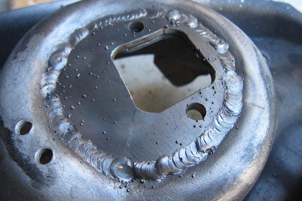

If you use your factory LCAs, you'll need to reinforce them to hold the coil over. I bought some 3/16" steel plate and made a round part to weld into the bottom of the LCA.
Here's the part.
All welded in place and ready to be cleaned and painted.

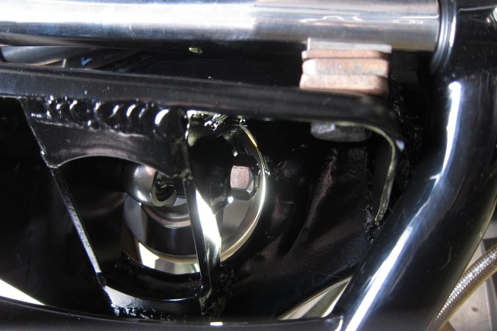

Everything back together and looking pretty.
As you can see, it's a tight fit. I've moved the suspension through its range and it shouldn't hit. These pictures where taken with the suspension hanging. The coil over will move towards the outside as it compresses. I'll keep an eye on things though just to verify. You can always open the spring pocket up some more if this is too close in comfort for you. I'd be careful though as there's not a lot of room left.

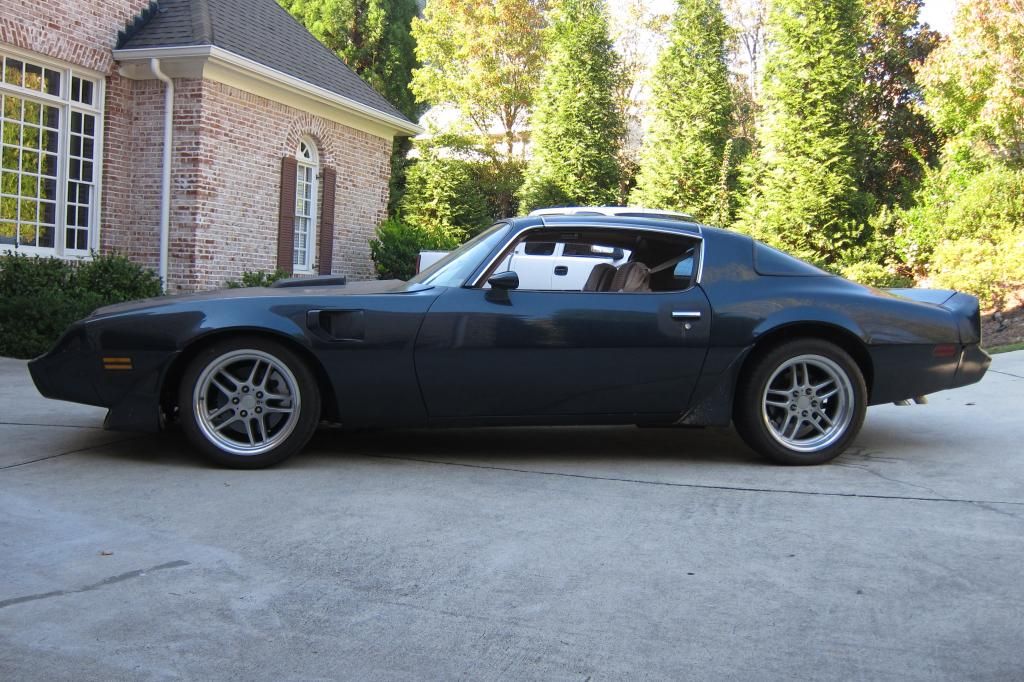

This last one hopefully shows the increased camber on the front end. Remember, this is essentially only changing to UCAs that has caused this increase in camber. The other factors remained essentially the same.
I'm going to have to give the rear some time to settle before I know if I'm happy with it or not. I really wanted the rear to come down some more and instead it went up at least an inch. I guess my stock springs were more worn out than I though. I'm building a street car mainly so looks matter. Unless an over riding factor presents itself, I'll be changing the rear suspension regardless of how well the monoleafs work if they don't settle low enough for me. One positive from being raised is I don't scrape the exhaust coming in and out of the drive way like I did.
