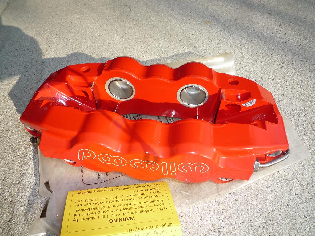

The cost is $1400 plus shipping. The kit sells for $ 2,000. The kit includes
Brand new Wilwood Billet W4A Radial rear disc kit. Complete kit provides the ultimate rear Big Brake solution for popular muscle car rear axles that require a parking brake.
* Billet W4A four piston calipers, * Red calipers
* 14" two-piece rotors
* high performance BP-10 compound pads provide optimized and balanced braking to compliment front big brake upgrades on all types of custom, show and high performance street machines.
* Parking brake internal shoe system provides a clean installation with superior static holding power for parking.
Fits Ford Axle with the dimensions below. Axle off set is 2.5 inches please check the Wilwood web site for more info
http://www.wilwood.com/BrakeKits/Bra...o=140-10948-DR
Complete kit brand new in boxes. Rear Brake Kit No.: 140-10948-DR
Check axle dimensions below. Below is what is included with the kit plus parking brake cables. $1400 + shipping (Complete kit retails for $2068.00)

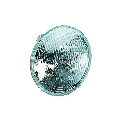

Well after driving the car at night I was not impressed with the standard headlamps. In fact it was rather sad I could barely tell if the lamps were on. I had a set of Xenon lamps but they had a convex lens which hit the RS doors so they never made it on the final build of the car. So I put them up for sale and Devil Dog picked them up and he got a good deal. I decided to install a set of HID, I looked at some of the ebay stuff lamp assembles and they seemed to be cheap so I decided to go with a tried and ture Hella lamp assemblies $70 for the pair. You need to buy the bulb separately. This allowed me to go after a H4 HID bulb assembly $40. I just got the parts this week in the mail (amazon.com) and installed them this weekend. The result was well worth the effort I went from the dark side of the moon to the blistering white light of the HID 6000k. If you’re thinking about doing this it is well worth it.

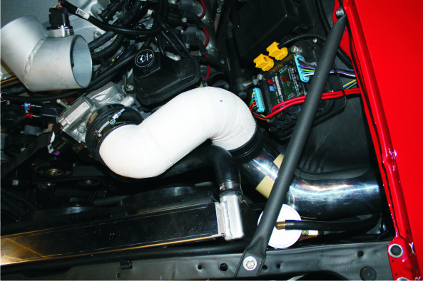

Well after months of looking at the air intake that I put in just to get the car running I finally made a move to redue the intake. Since I just changed out the headlamps with the HID units I took the opportunity while the car was taken apart to get this done. With some help from Guy over at SPECTRA I was able to get most of the components. But there was still one issue. If you are planning on putting a LSA in your vehicle get a radiator with the return on the passenger side. The offset intake forces the air tube to be on the driver’s side. At the time of the build this is one item we overlooked and the return of the radiator is on the driver’s side so this makes for a tight fit for the air intake tube to be routed to the motor. So with a little ingenuity I made up this mockup pc out of Styrofoam and I am going to make a carbon fiber tube that will fit around the radiator and meet up with the other components. If your building mock ups with styrofoam you need to use epoxy or white glue to glue material together, styrene based glues eat the foam! One cool feature is that I can lay-up the epoxy resin over the styrofoam and once it is cured then I can melt the foam out with lacquer thinner, similar process to investment casting. Here is a picutre on the way it was and the mockup air intake pipe.
