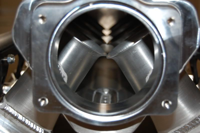

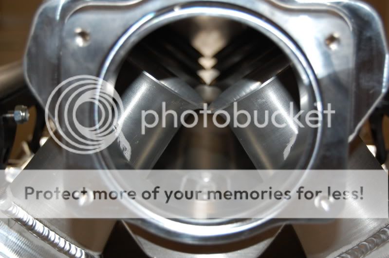

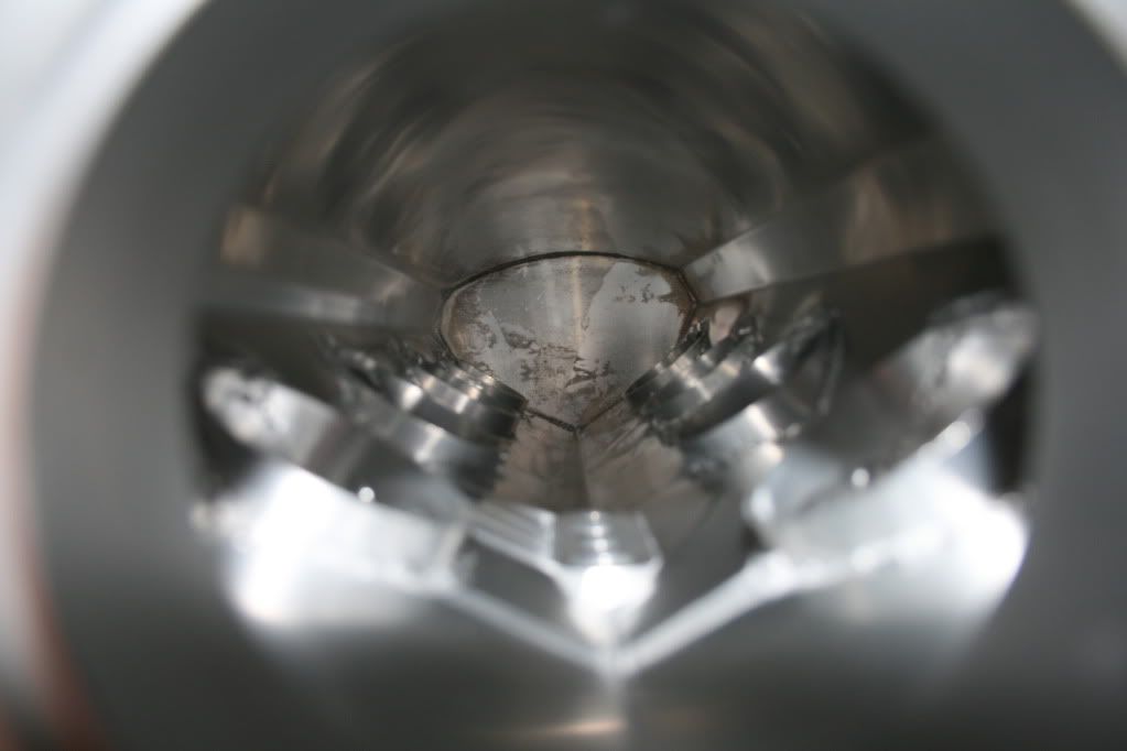

Ok, stupid question... what exactly is better about the quality? Are the flanges not flat? Holes in the welds? Poor quality aluminum?
I know most Chinese stuff is junk, for typically those type reasons...

This:
versus this:

......and that gentlemen, makes all the difference in the world. (as they say)

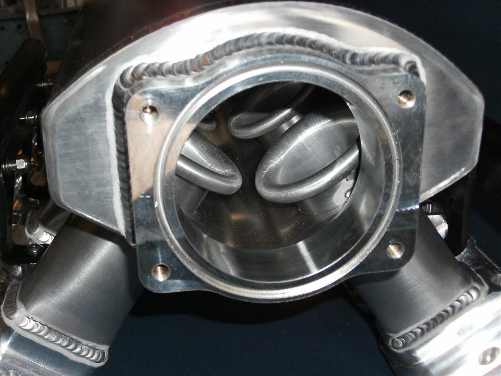

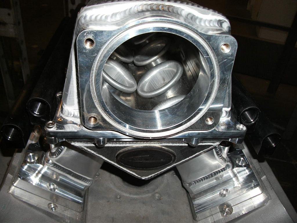

Don't mean to hammer my own part and there is certainly nothing wrong with it (night and day better than the China part). But in case people are not aware the newer ones look like this on the inside. They have been this way for about 3 years.

i guess after looking at that picture you could say ...every girl looks good with her pants on!!! lol
