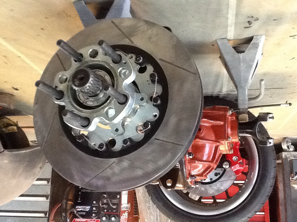

Old 09-18-2014, 06:36 PM
Rick D's Avatar
Rick D Rick D is offline
Posts: 3,437
Nice job, I like the color!! Who's rear suspension are you using? Also what rear caliper brackets are those? They look like they are welded to the axel tubes?
Rick
  #76
Old 09-18-2014, 06:54 PM
Stovebolter's Avatar
Stovebolter Stovebolter is offline
Join Date: Mar 2008
Location: Harrison, AR
Posts: 301
Thanks Rick. The rear is of my own design so to speak. I had a lot of help from many members. Used Air Ride TQs. Made my own air over hydraulic tubing bender and started bending. Caliper brackets are my design. Laid out on poster board and cut out of 3/8" plate. Yeah....I'm an off road guy. Lol. Yes. Welded. The trick was getting the calipers centered back on the rotor after welding. A couple whacks with a 5 lb sledge. Centered perfect. Checked toe and camber. Everything checked good.
468 BBC, TH400, Moser 9" floater, True Forged Competitions 18x9.5 18x12, Kore 3 C6 ZO6 calipers 14" & 13" rotors, Ride Tech True Turn, Ride Tech Air TQ's, Torque Arm with Watts link, Moser CT Full Floater 9" with locker.
  #77
Old 09-19-2014, 05:49 AM
Payton King's Avatar
Payton King Payton King is offline
Location: Charlotte, NC
Posts: 2,576
Thanked 23 Times in 18 Posts
I like the progress. Make sure you run axle seals in that thing...and they will still leak a little.
  #78
Old 09-19-2014, 06:22 AM
Join Date: Mar 2008
Posts: 301
Thanks Payton. I believe I read somewhere that Moser has improved the design of the seals. Man those buggers are a pita to get in without damaging the first o-ring. But I got them. I opted for normal high temp disc brake wheel bearing grease. I read to stay away from the tacky synthetic grease because it wouldn't stay in the bearing. Oh....and thanks for your help Payton.
