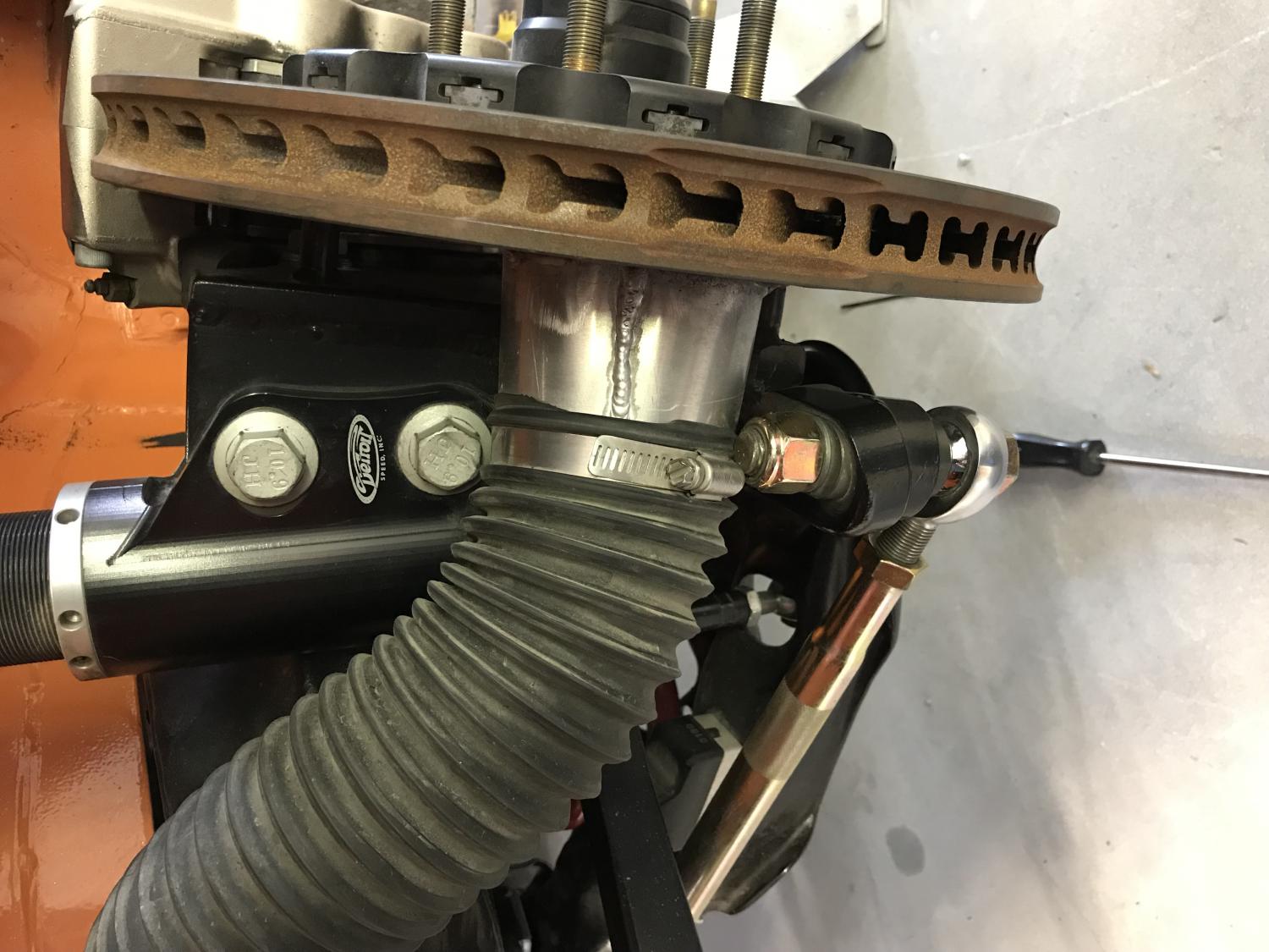

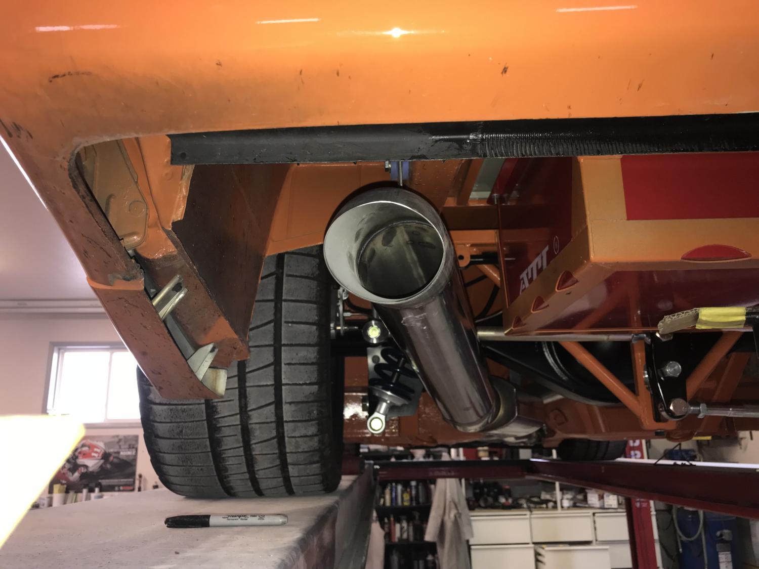

Some pics of how I did the brake cooling ducts and how I ended the 4” exhaust

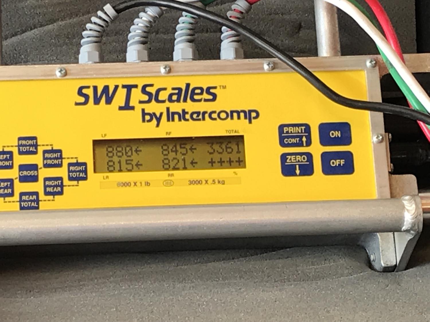

This thing is freakin' cool!
What are the drivetrain specs?
Final weight?

The engine is a GM crate ls3 with a Texas speed stage 1 cam and minor head work. It’s makes 500 hp 473 torque a tremic tkx and a wavetrac with 3.73s. The weight is with a 100 lbs in the driver’s seat.
