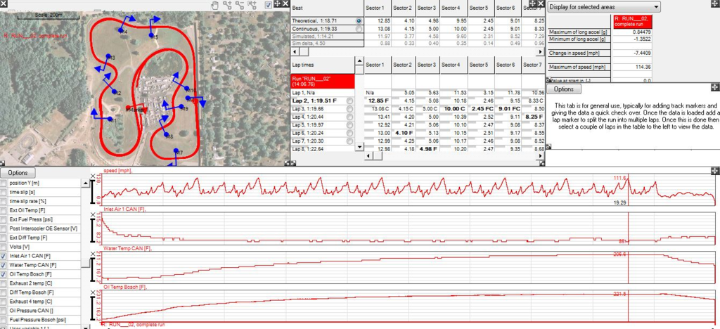

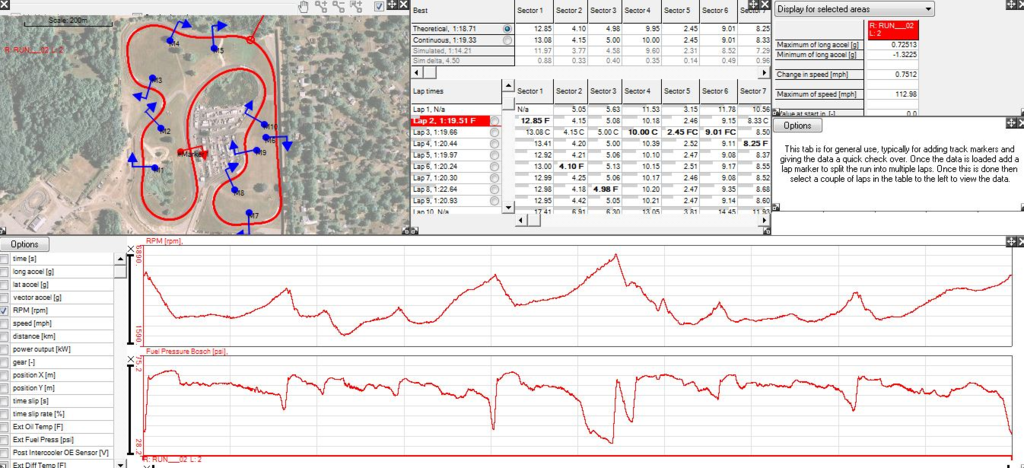

We had a good test at Waterford. I had some good data and some not so good data.
The cooling system worked great.
The ambient air temp was 87 F. On a 15 minute session the oil temp stabilized at 207 F and the oil temp was 231 F.
Now the bad news the fuel pressure is still falling off with high load.
All this data is off my built in Race Technologies dash. It is nice to look at data after the test and have to relay on looking at the dash.
