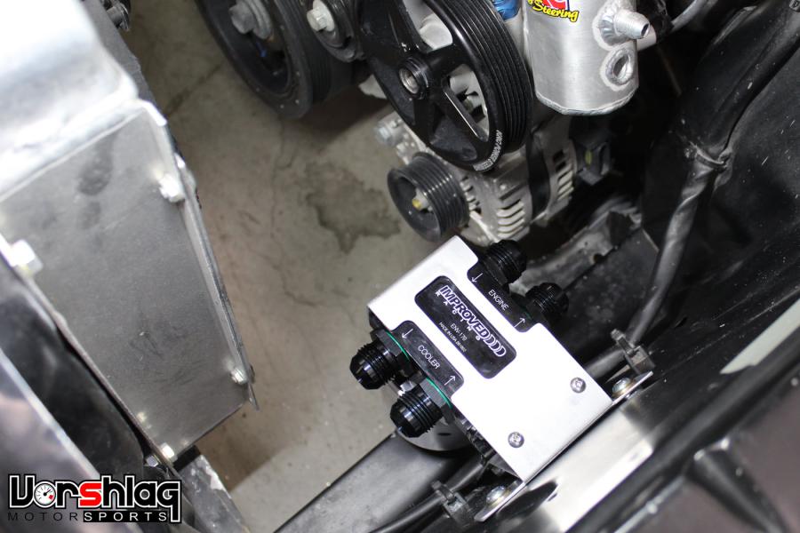

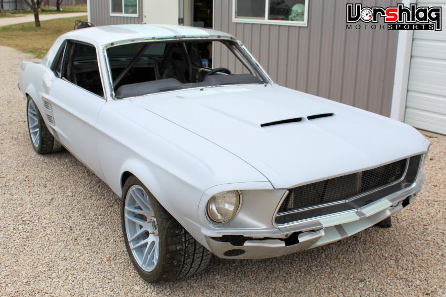

After a short winter hibernation the car is back in the shop at Vorshlag. Terry and the crew are currently plumbing the dry sump system. Making progress

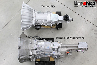

I have yet to drive a car with the new TKX.... do you have any feedback on how smoothly it shifts compared to a T56 Magnum?

Car still isn't driving. We are finishing up the oil/cooling plumbing, then wiring harness, cage, and a driveshaft. At that point we can start doing some testing. Hopefully soon
