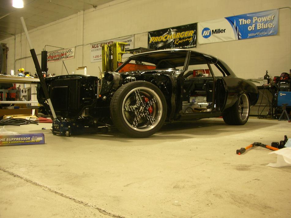

This is a turn key car we're building. It should be completed by end of month,
Thought you guy's may want to see some progress pics. There are more pics of the build are on our site if ya want to check them out.

Build;
383 sbc, 9:0:1, Dart headed-forged everything....
D1SC procharged-non-intercooled.....Thanks D.W.!!!!
Big Stuff 3 controlled
Ricks custom tank w/A1000 inside....Thanks Hector!!!
4 spd auto
12 bolt, True trac, 3:55's Moser's with torino ends.
Willwood Six piston 13" front, four pistons-12" all cross drilled & vented
Full Air Ride Street Challenge Set up W/ big red level pro....Thanks Tony!!!
18" frnt, 19 rear Custom One off American Racing Wheels......Thanks Chris Codington!!!
Mini tubbed and threw floor conectors
Full custom interior w/ custom four point bar with removeable back bar.
and there's more I'm sure I forgotte....
finish paint on body will Satin Black
See you guys on MtV!!!!!

The camaro looks awesome. The camaro is being built for Rob, from the TV show "ROB & BIG". I was at "ALLSPEED" today and I saw them put the wheels on the camaro, and then set it on the ground. The camaro sits nice and low, everything clears. This is one of the nicest camaro's I have seen.

What is the deal with those wheels?
Mike
They have the Rogue Status logo, witch are guns machined in them.

I am with Mike about the wheels. I thought it was some sort of protective covering or something.
Can you give us a close-up pic of the wheels?

here's some more angles.....

After seeing what's on the wheels (M-16's), it matches Rob's personality that you see on "Rob & Big". I kinda dig the wheels

Ya you either like the wheels or you don't....at first i kinda didn't, but on the car, they look pretty cool.
