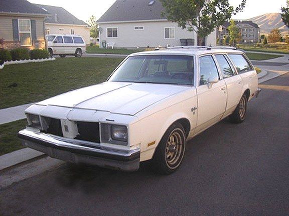

This is what it looked like when it followed me home...
