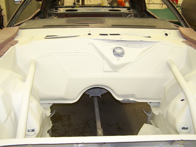

Rear body mods: (Car in 1st primer stages)
Narrowed and sectioned bumpers to tuck them tight in the body.
Re-worked the quarter panels and recessed for the bumper
Shaved the marker lights
Fabbed lower roll pan
Fabbed spoiler that is welded to the decklid with ends part of the 1/4 panel
gor rid of the stock rear body panel and tail light housings.
Made the tail lights mount from inside the trunk and eliminated all trim
Fabbed single, center exhaust tip

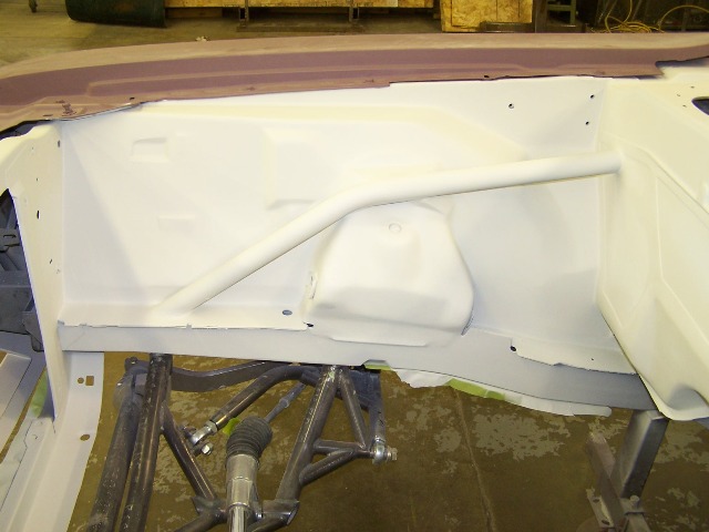

Front Body Mods:
Removed headlight doors and trim around tip of fenders and removed the hood front edge molding. Fabbed all out of steel and made them part of the fenders and hood.
Sectioned, narrowed, and tucked front bumper.
Re-worked front fenders for a flush mounted front bumper.
Shaved marker lights
Fabbed lower front spoiler/splitter
Black Halo headlights
Fabbed custom hood

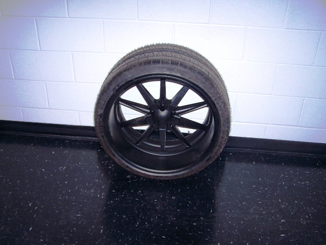

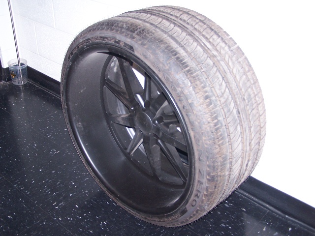

Posts: 1,120
A few more misc. shots
22x12's in the rear with 335 Pirelli rubber
www.roadstershop.com
