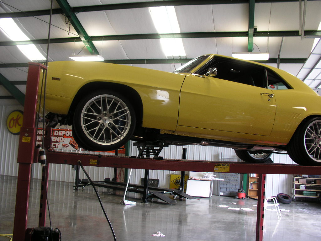

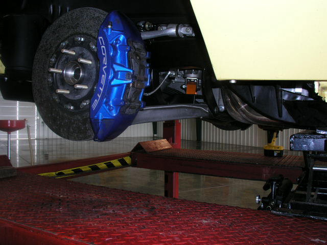

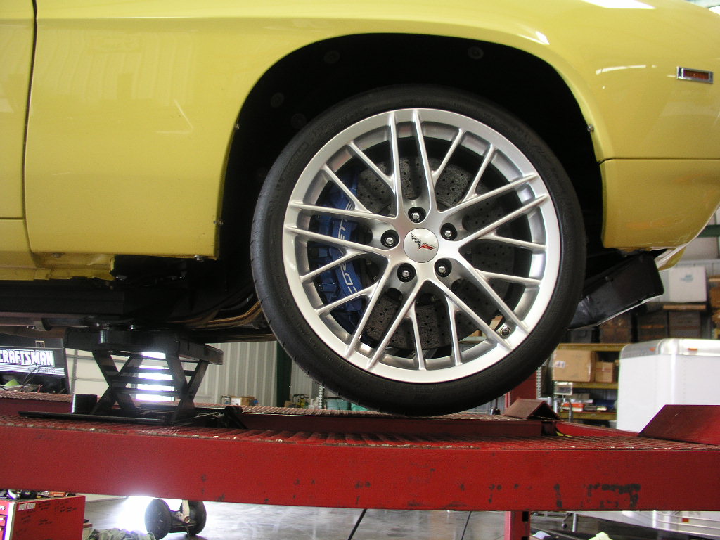

I don't understand. I just took these pics. I'm going to be playing with the sway bar. I don't see where I couldn't swap out control arms or do any other front end work. The rear can also be lifted.

That's way too high for me to work under....

Take that front wheel off and duck under that lift 100 times a week to work on the inside of the hoist and then the outside. I was auto tech with GM from the age of 19-22ish. I've worked on 1000's of cars on hoists. Boy I don't miss those days!

But nobody on this site is going to be ducking under a lift 100 times a week. You can do just about anything with a 4 post that you can do with a 2 post plus you can do exhaust work with the suspension compressed etc. The negative to a 4 post is if you have something like a late model Camaro you can't drop the subframe. You need a 2 post to do that. I worked in a shop for about 6 years that had in ground lifts that had that had the arms you swung around and they were a pain. All this stuff is better now. The sliding jack that I just lifted the front of Jackass with took 4 posts to another level. I can pop a balljoint and work on the suspension at any height I want. With a 2 post I would be down at ground level with the jack on the floor to support the lower control arm. I can see if you are something like a brake shop where you are pulling wheels off every time the car is lifted that a two post would be faster but for the average guy on this site I still think a 4 post is the better way to go and safer.
That's because....You're short!
Also you can lift as little or as much as you want, so...???
