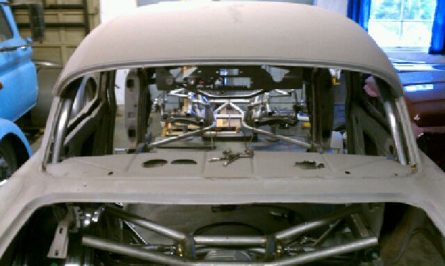

A few more showing frame and stance. Mock motor.
Obviously, the frame in not complete, but here is a few in progress. Notice the cage and its inset into the body.

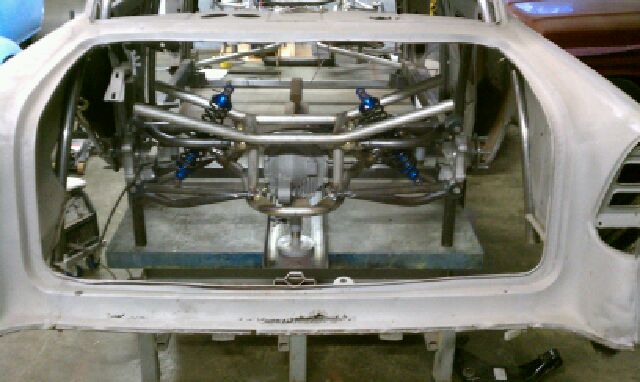

Well, car is coming along. We were able to narrow the 2010 Camaro rear end by 10 inches to our specs. Refab it out of tube and replace all those weak trailing arms with custom fully adjustable ones. Ordered up the HD axles to accompany the predicted power. All rubber bushings have been replaced with solid mounts to reduce any possiblity of flex.
The front clip is being re-attached to to body for fitment.

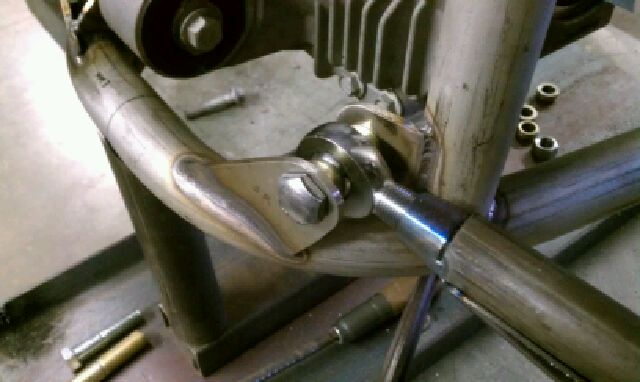

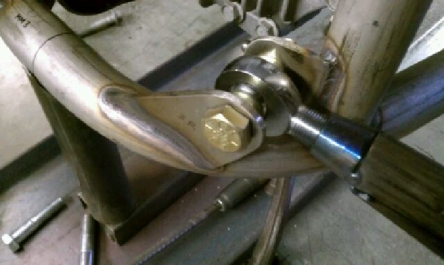

Heres a few more updates from today.
Rear subframe is inside car and we are fabbing mounts. A few pics of the trailing arms refabbed. A pretty good side view of stance of the car.
