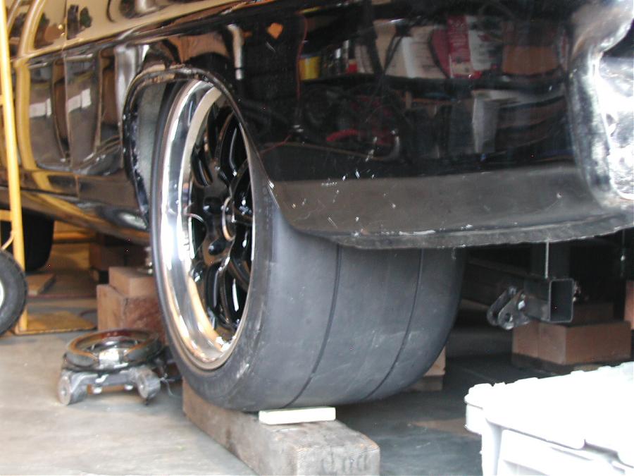

Pics of the new wheels on the Vette and then I mocked up the left rear to measure out suspension parts to keep ordering. What I like about using wheels with a lot of backspace is then when the car is on the ground it looks a bit more of a sleeper - people would likely assume stock-ish widths at first glance and just think the car is a bit of a classic upgrade... until you get down and look at the width of the tires
Also seeing how the 295 and the 335 fits a bit narrow IMO is promising as well for running a 320/355 race slick setup down the road.
