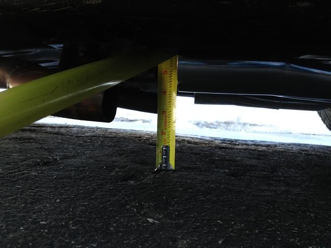

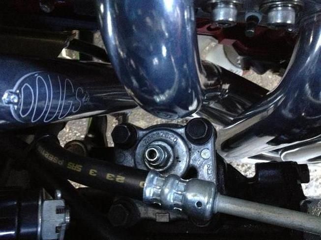

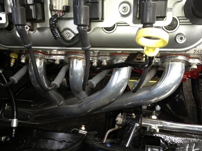

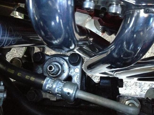

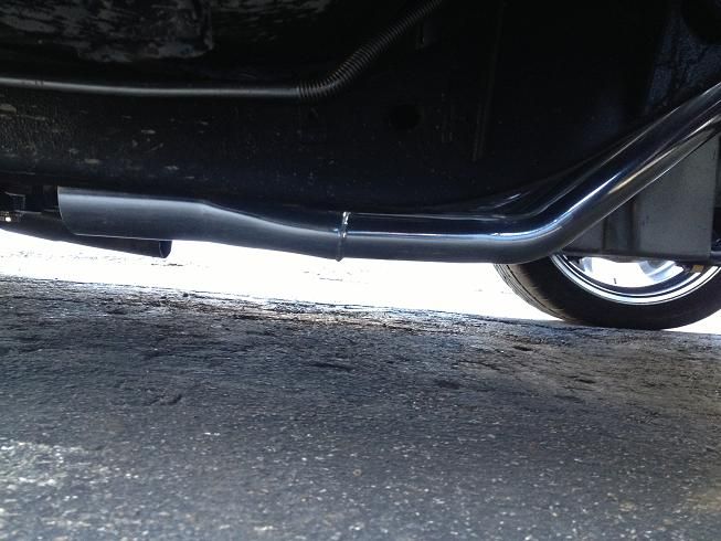

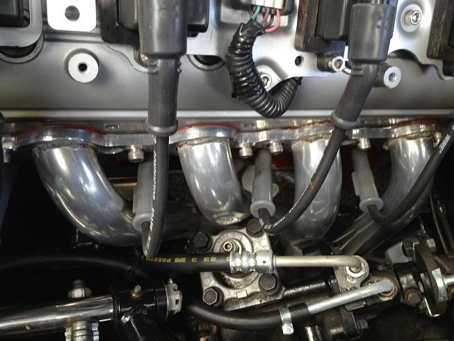

Well, after a few weeks of researching, emailing, PM'ing, three different threads on three different sites...I had narrowed it down between the Dynatech's and the Doug's 3337's. I ruled out the Texas Speed because there just wasn't enough info on them, and I wasn't crazy about the design.
The guys from Dynatech were great with trying to help, but it's the same design as the Texas Speed stuff (still wondering if Texas Speed copied them, or if Dynatech is making their headers).

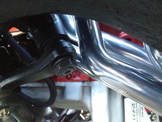

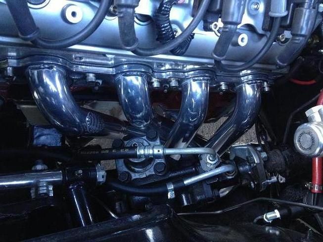

So I ordered a set of the Doug's 3337's (jwcarguy's pics helped push me to the final decision). My only hesitation was that they look identical to the ebay brand headers that I was looking to get rid of. In fact, when I first got them, I thought they were identical, but there are subtle differences in the tube design (i.e. the guys in China didn't do a perfect job on the knockoff). I installed them this weekend. I ended up moving my engine and transmission about 3/4" back towards the firewall and I'm very happy with the clearance.
ebay Header passenger side:
Doug's 3337 passenger side:
ebay Header driver side:
Doug's 3337 driver side:

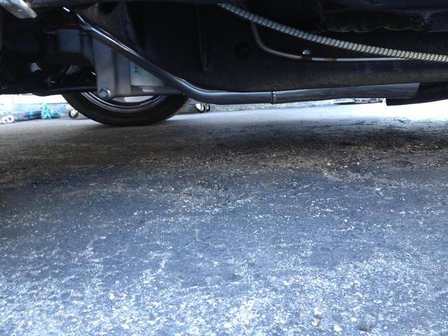

Doug's clearance:
Doug's driver side ground clearance:
Doug's passenger side ground clearance:
About 4" of clearance on passenger side, and 4.5" on driver side:
