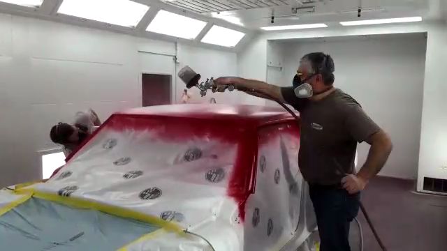

The customers Birthday is today. What better than being able to show him a short clip of the car getting sprayed!
Jason is correct, We are using the Raptor bed liner, We really like using the Raptor, It doesn't go on too thick and isn't really flat.
