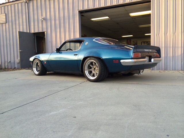

Better side shot taken today

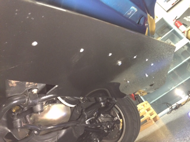

Splitter is bolted to the existing body and
spoiler bolts. Then a bunch of sheet metal screws
into the Fiberglass. Been tested to 100mph so far
Picture note the best

Did it help keep the front planted at higher speeds, Bob?
Thanks for the side shot!

Great looking Bird Bob. Love the color, stance and styling. Big fan of the splitter. Keep the pics coming.

Does the spitter work?
Front seemed pretty stable on the car
before so hard to tell. Only a blast
Down the freeway quickly to make sure it
stayed on. Working on the rear one next
which will be an extension on the TA tale
Squared off will work better but I am going to
cut it angled on the ends as it looks better
Then time to cut the fender vents
Was going to do hood vents but too
many things in the way
Thanks for the comments

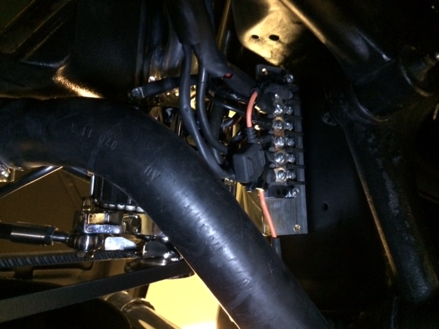

Been fighting an electrical short for a while
and finally figured out my one wire alternator
(actually has 6 wires going to it) wires were all in
a fan formation to get them to fit would move and
loosen as the engine torqued.. bought a terminal
block.. Modified it and now have them all in a row
so hopefully no more non starting or lights out issue
