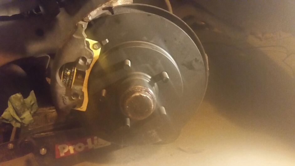

Got the EBC rotors and yellow stuff pads on the truck.
