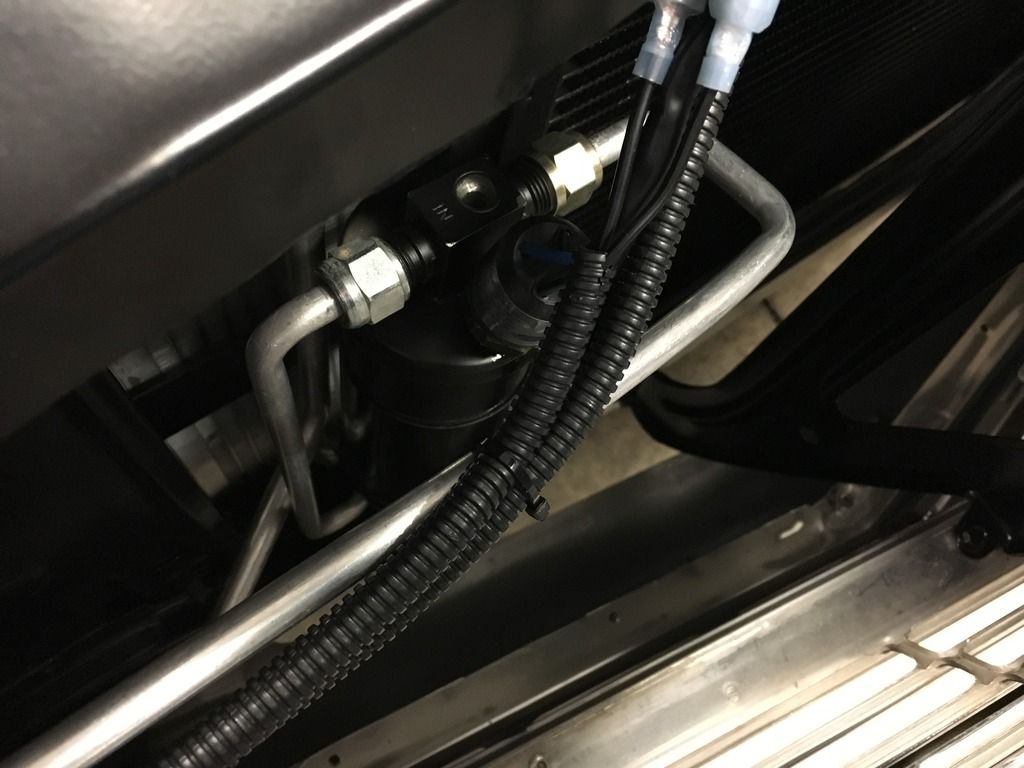

Got the Fuel system pretty much completed today......Fuel Pump fit and installed........Fuel Level Sender fit and installed........Filter Regulator installed and lines made........Then got the Tank installed.........Wiring for the Pump and the Dakota Digital fuel gauge installed also........Moving along..........
