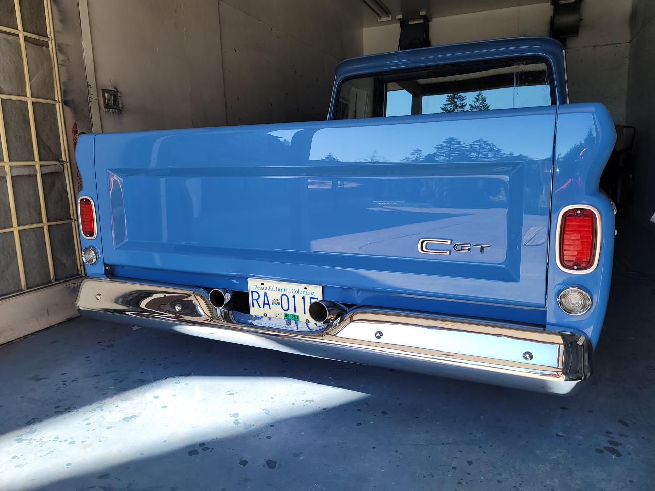

Had a few buddies over for the marriage of frame cab and box.

Got some doors and fenders added.
Name:  fenders on 2.jpg
