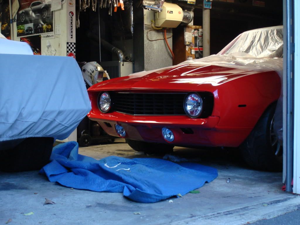

Got a chance to assemble the headlight buckets, DSE lamps, and trim. The parking lights are Marquez, and installed the endura bumper, which I might add was a brutal install. I almost sailed it out in to the street a few times. They fit like crap. I had to cut and modify every bracket. Im not crazy with the fit but I think I will live with it. I dont have to many alternatives, Im trying to get some info on the smoothed bumper from year one but getting no responses. The endura on the car fits low in the center and high on the ends, I guess its not to bad.
Rich

Rich we have to do something about that bumper. Cars WAY to nice to let that go!!!
Mario

I was at a local car show this week end and a guy pulls in with a yellow yenko clone, it had an endura bumper on it and it fit just like mine. Have you ever seen these things fit up perfect? The pic doesn't show it well, its actually the painted edge of the grill isn't at the same level as the bumper between the center and the ends. If I drop the ends then theres a big gap at the ends and they dont fit into the corner pockets. If you guys have this bumper please comment on the fit, this thing beat me up.
Rich
