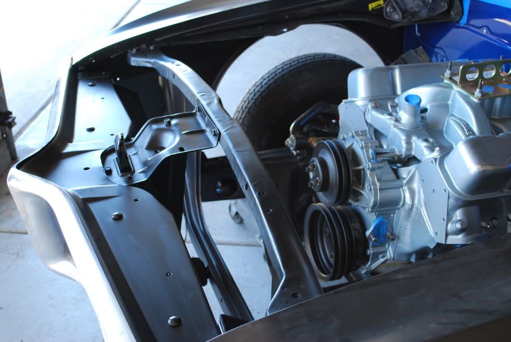

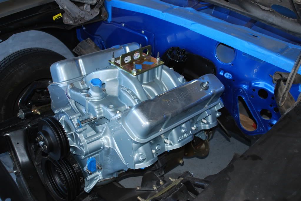

To answer your question, it's a 400 stroked to 461. I used a forged rotating assembly and 87cc Edelbrock heads with some mild porting. I also switched out the springs and running a Tomahawk solid cam @ about .525 lift

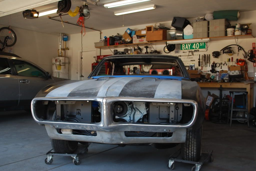

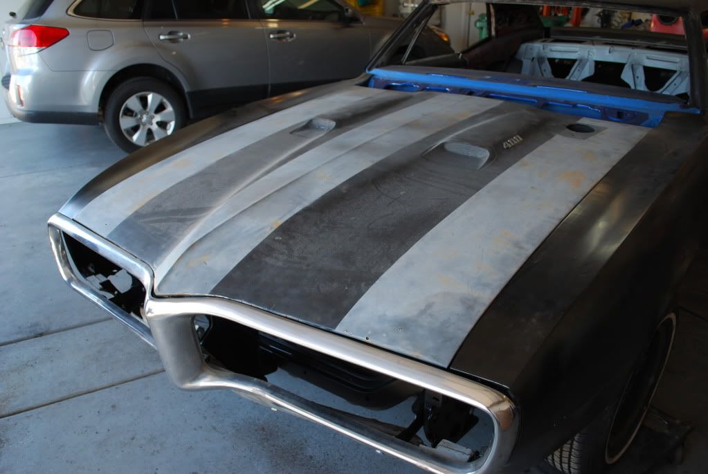

Thanks for the comments
I've been working on the gap between the bumper and front-end. I know that from the factory, this gap was pretty large. I'm trying to get a uniform and closer gap here. Right now if you look from the top down, the gap is tighter towards the center of the hood and wider as it goes out to the fenders. Can anyone offer any tips or advice on getting this as close and as uniform as possible?
I've also been thinking of buying a new fiberglass bumper. My reasoning here is that it may be easier to work with and fit the fiberglass bumper. If I keep the metal bumper, I was planning on painting it body color anyway, so the fiberglass would work out in my plans. Any thoughts on this or experience with the fiberglass bumpers for this car? I found a company named UP22 that sells them. Anyone deal with them?

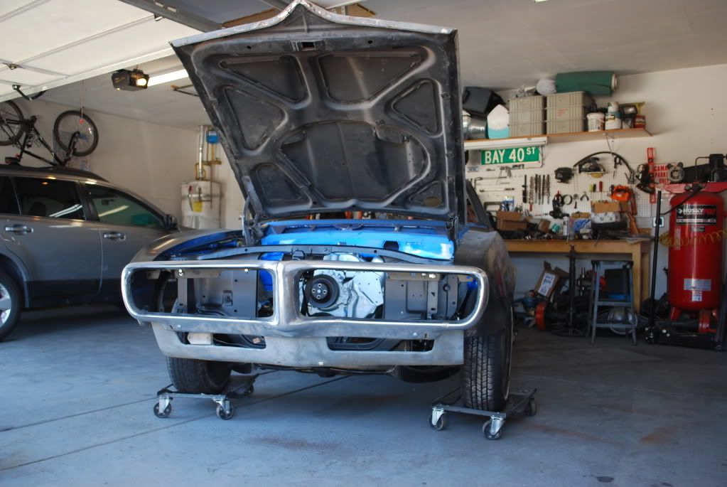

I worked on it some more this past weekend and got it much closer. I had to tweak my bumper a little, basically just bent in the outsides a little. I don't think this is the original bumper because there are no holes in it for the pontiac emblem. From what I can tell, the 400 cars had this on the bumper. Also, who knows what happened to this bumper over the years.
Currently, the gaps are much more consistent. The only issue is that the gap is a little closer towards the middle (center of the hood) and gets slightly larger as it gets towards the fenders. I'm still trying to decide if I can live with it. I'll try and take some pictures this weekend.
