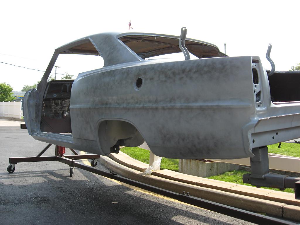

Minor body Shaving:

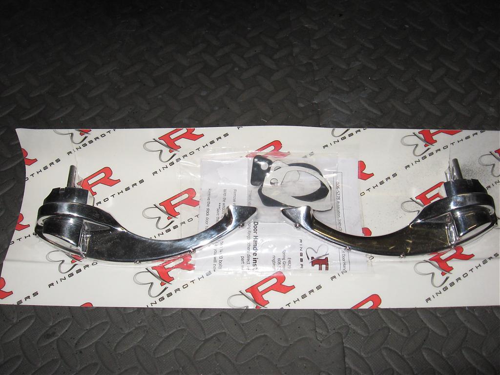

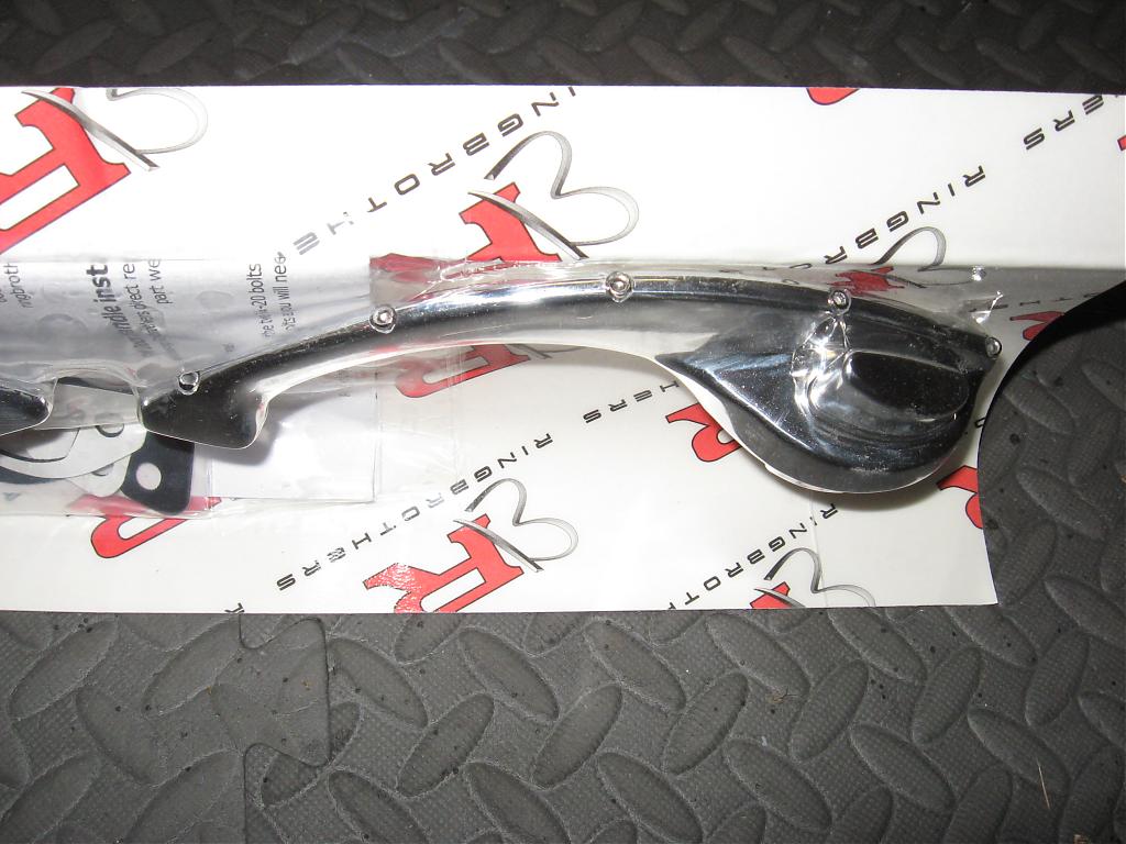

Ring Brother Hinges (slightly modified to fit CA clip).
Fabricated Front Radiator Support Valance:

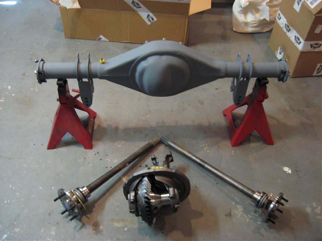

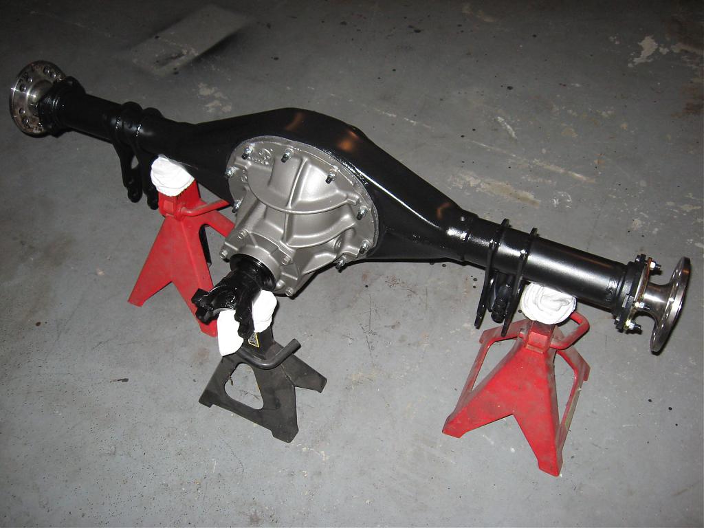

I little change in plans as far as the rear end goes. Trying to keep with all things "bolt-on" or available aftermarket, TCI (Total Cost Involved)stepped up with one of their "bolt-in" rear housing assemblies. This assembly is complete to order: cut to length, proper bracketry with proper drive angle, choice of gear ratio, 31 spline center section posi. Its as close to a custom made to order rear but in a "bolt-in" package.

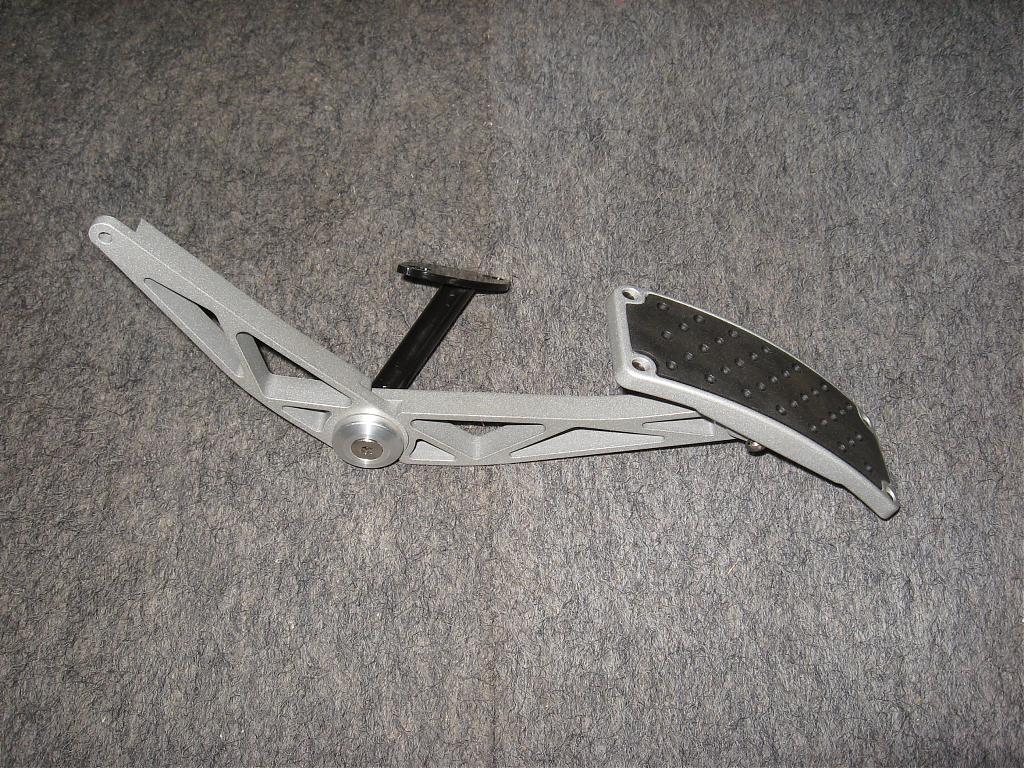

We have also opted for Clayton Machines Pedal assemblies. All I can say is WOW.... Stay tuned !
