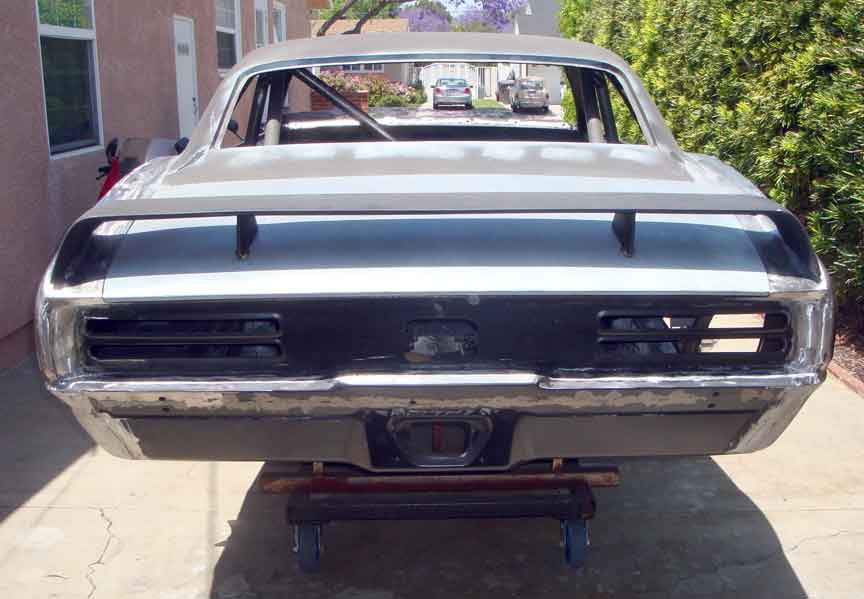

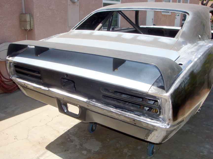

How about recessing the tail panel???

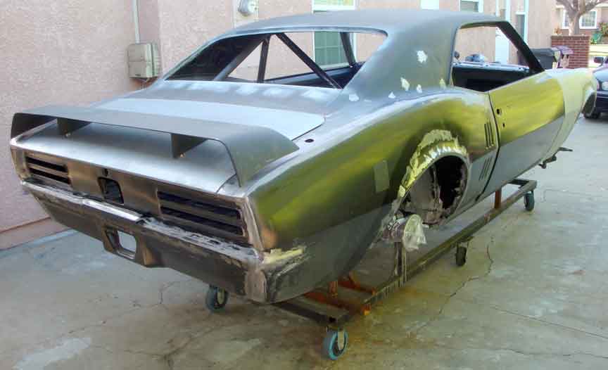

I was starting to wonder if I'd ever be able to get this thing to start going back together - and finally it seems to be starting.... Pretty happy with the alignment so far. Still deciding if I want to play with it some more while I figure out everywhere that needs to be welded! The only area I'm currently concerned about is the sail panel area. It seems to be a bit wiggly near the bottom of the drip rail and I don't like the way it meets the roof panel. Outer wheelhouse is also mocked in and seems to be fitting ok. Still need to finalize the passenger side and then it's on to welding!
