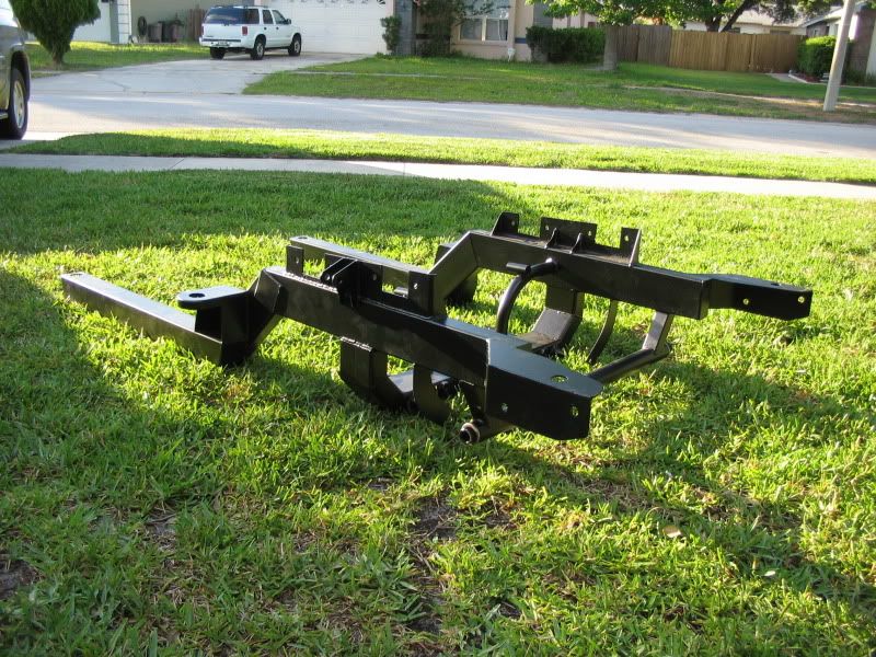

Wanted to show my nice piece!!! aint it pretty!!!
68 SS Camaro LSX/T56 in work, SMD subframe, , DSE Mini tubs, Fikse Profil 13's, Alston G Link, and other parts!! ,
