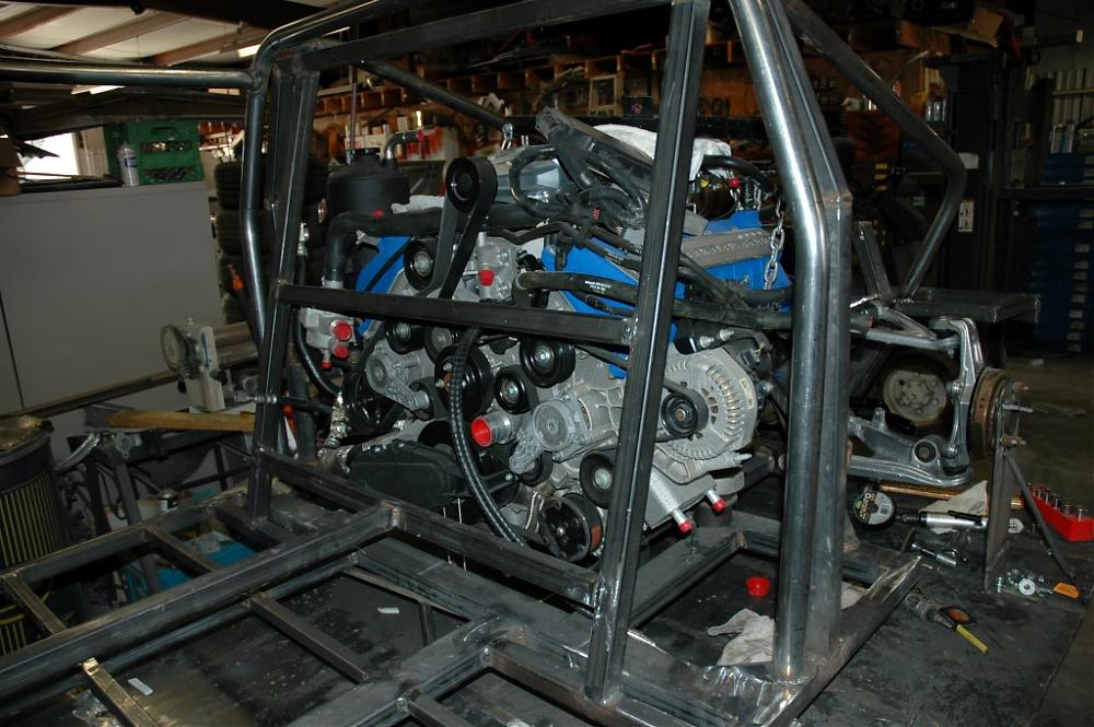

Originally Posted by Karl Buchka View Post
...Why is there a roll hoop made from round tubing as well as something resembling a roll hoop made from square tubing?
I think the round tubing is part of the roll/support cage. The square tubing right behind it is for mounting the flat sheet metal which I assume was for close out panels to close out the cab from engine nose. See the last pic in the build in post #66 on page 7.

I kinda threw it together a the last minute for the super summit here in atlanta and had to go back to finish alot of little things air,radio etc and had a problem with the push button start but its almost all done. As for the design of the chassie it's built from 1-1/2 square and 1-1/2 by 3 and 1-5/8 round. There is a fire wall that completely incloses the engine seperate and the cage strenghting the chassie.

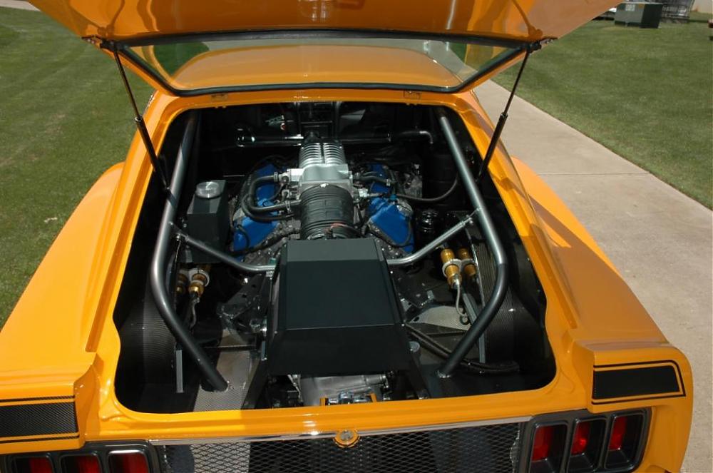

  #95
Old 06-29-2013, 07:07 PM
REAL BOB JOHNSON REAL BOB JOHNSON is offline
Join Date: Jul 2006
Posts: 95
engine pic

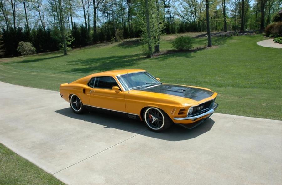

Old 06-29-2013, 08:28 PM
Hardluck13 Hardluck13 is offline
Join Date: Apr 2009
Posts: 19
So dam badass. Any interior pics? You nailed the stance also, it looks tits.

Bob - Simply awesome build! Most even never come close to a personal accomplishment of this stature in their lifetime. Congrats

drove to maggie valley from atlanta last week end to a all ford show over 200 miles and got 20mpg and never got warmer then 185.degrees. This mustang is probably the best driving car I ever built. left that show sat. nite and came back to atl. and went to another show at summit racing on sunday and by the way won both shows and best of show
