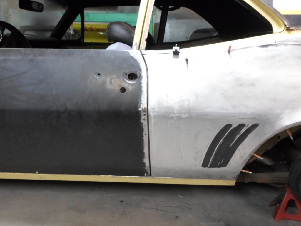

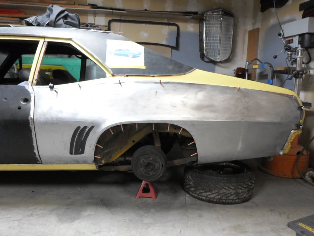

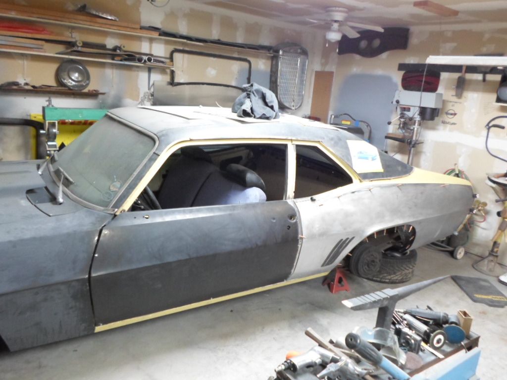

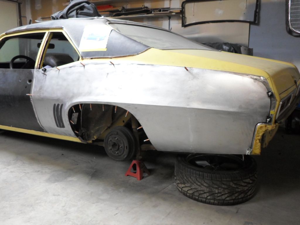

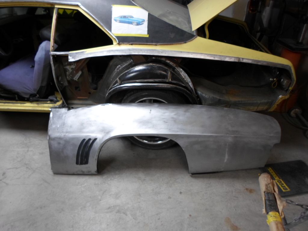

So the next step is to graft the 69 Camaro door skin to a 73 Nova Door so we do not have a wing window. We also will replace the Inner/Outer wheel house with the Camaro one and DSE Mini Tub and put the partial 69 Camaro Quarter.

We will be putting Camaro tail lights in and section the bumper to tuck it into the body better. It will all be primer soon so you can see it all in yellow. We did get the aluminum front fenders but not sure if we will keep them on this.
