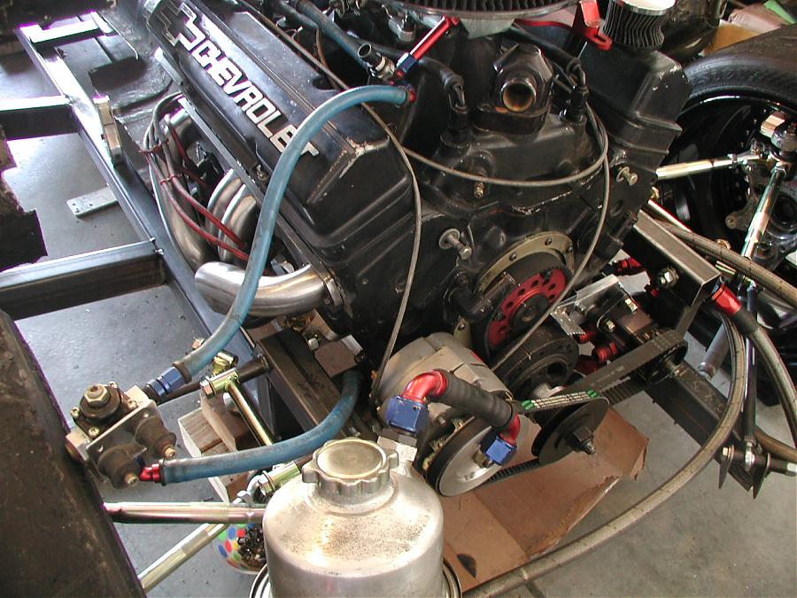

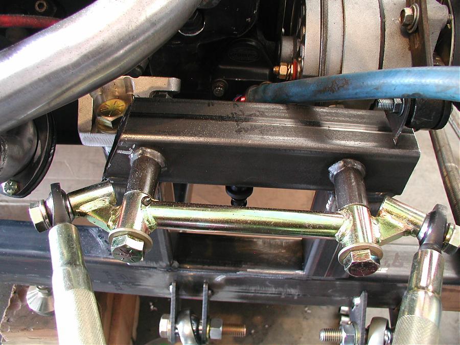

Got the Sanderson headers and some other misc parts from Summit last week These 1-7/8" shorties are pretty bitchin' actually. I also modified some SBC to Model T engine mounts on the vertical mill and they look to be a great solution to having a two bolt engine removal at the block as I can access the bolt between the header pipes. I had some old tubes with heim ends left over from the Porsche 5-link that I can then weld into place (can't see in the pics very well unfortunately).
I was messing with putting the oil tank up in the front on the passenger side but the serious risk of that is having it burst open in a frontal impact and engulf the whole front of the car in an oil fire. It is sketchy enough having oil coolers let alone adding to it, so I am going to consider taking some more passenger foot well and mounting it there. If I get it low enough I shouldn't have too much issue getting the cap off from the engine compartment and putting oil in it.
Right side shots also show, if you look closely, the fitting for the fuel coming in to the pump - I pre-notched the upper A-arm mount and that fits right inside of it. Final shots show what remains of the floor pan, which is to say the center tunnel and the rear seat shelf.

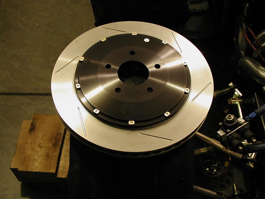

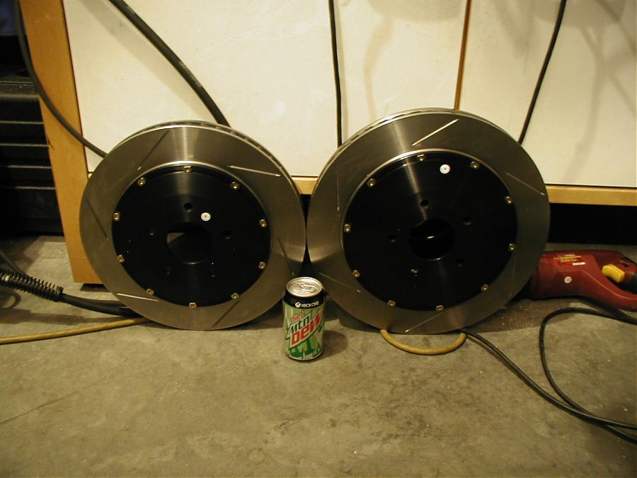

I might be responsible for my local UPS man's salary this month Maybe I should ask for a cut.
Got a tubing bender Monday and picked up a bunch of 1-1/2" x .120 wall DOM last Saturday so it is about time to start teaching myself how to bend up a cage. I picked up my BBK at 3ZERO3 today and got home to find McLeod got my stuff out to me last week as well.
We will see how the "soda can turbo thing" works with brake packages. At minimum at least the Junior Nation has something to appreciate. The kit is the "extra big" BBK for late model Corvettes as I mentioned previously which puts the normal 355mm (14") front rotor on the rear then adds a 380mm (15") front rotor setup. I laid them across the front 295 width tires for some comparison but those may be a little dark to get a good idea. I really wish I had an old pad from my Porsche 930 Turbo brakes - the rear pads are probably twice the pad area those were.
