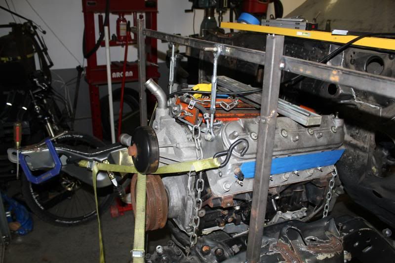

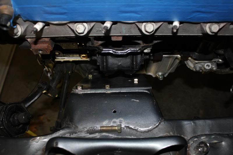

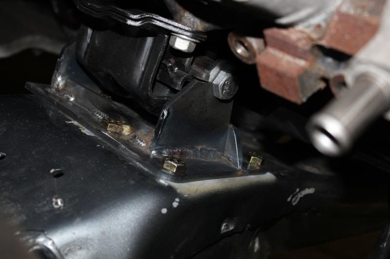

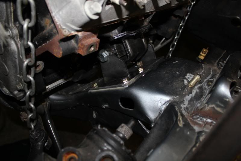

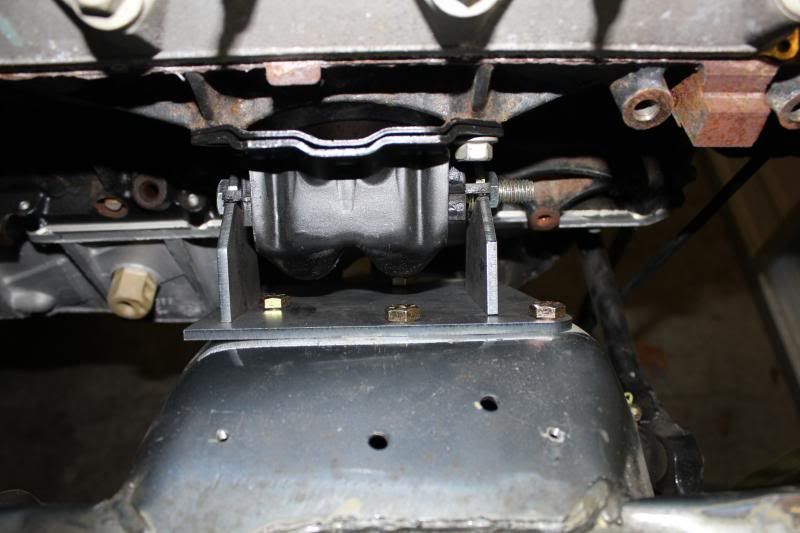

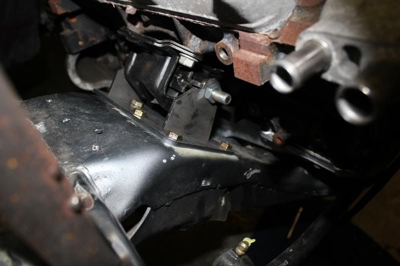

Well, It's time for a little update. Got the engine mounting completed. Kind of like a milestone with swapping the engine out to the late model stuff.
First I took a little tip from FAB53 and built a hanger. This was to get the engine off the spacers I put in when I got it set where I needed it.

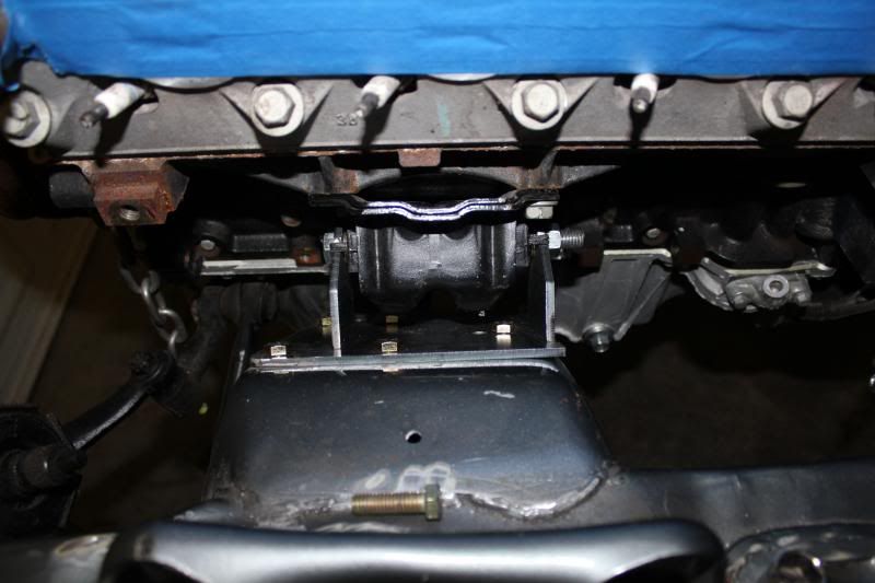

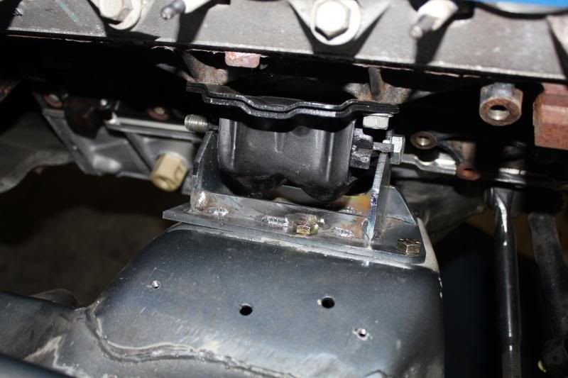

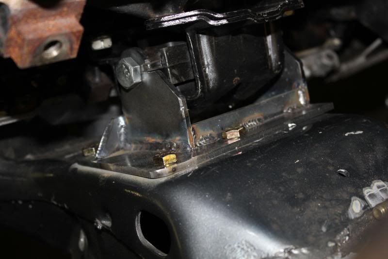

Had some plates made to bolt to the frame itself. Kind of going the Stielow route.
Installed the uprights with some spacers to make sure I had enough room for it to slide in.
Passenger Side
Finished product
Bill

Thanks guys..... It took too long to get them taken care of. Probably going to install the front suspension next, then work on the rear tubs.
Bill

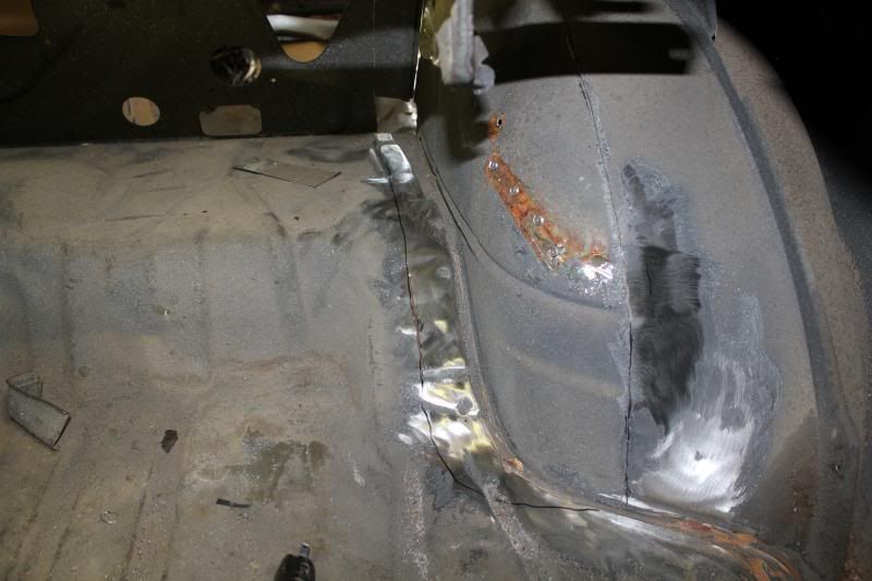

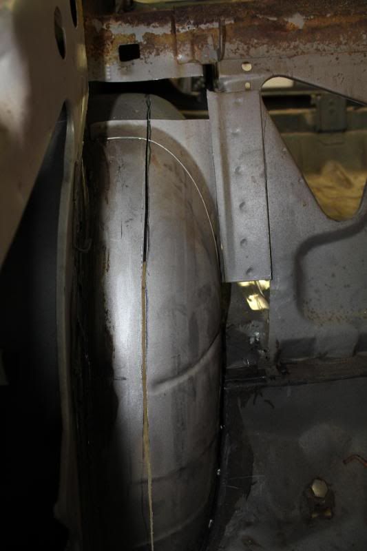

So I finally got to work on the ride today. Got my nerve up to do the rear tub cutting. And of coarse, I hit a road block. I'm cut all the way through to tub itself, except down to the lower area of the tubs front and rear.
So the little snag is, where you see the line on the trunk floor that is where I will be cutting back the 2", that is right over the trunk brace in this picture.
so. I'm guessing that I need to not cut back so far on my first cut. Then after i band the tub, I can cut back more as I need to. Is my thought correct?
Thanks,
Bill
