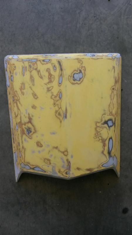

Deciding on a location for the Cyclone scoop, and prepping it. It was boogered up and needed glass in the corners, and holes filled.
Had to cut a hole in the hood a few inches smaller than the seal.

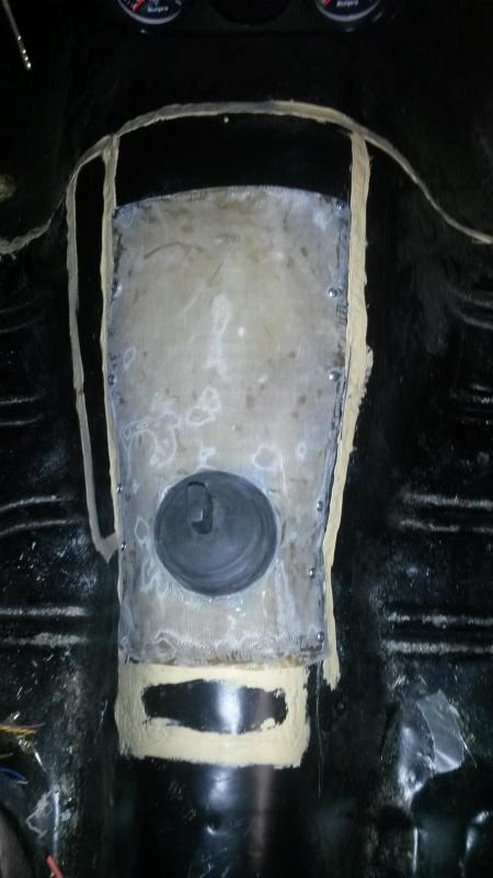

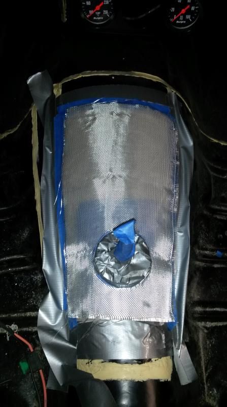

I made a tunnel cover out of fiberglass for the TKO since I am not so good on the "english wheel"
Has some more cleanup work and it will be ready to go

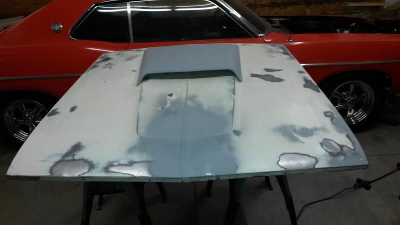

Started working on the Ram Air inlet modifications to the inside of the hood. I had to cut out some bracing, form a ring from 18 gauge, weld it back in to strengthen the bracing, etc.
Working on the outside of the hood now,it was dented up, and fixing the glass on the Cyclone scoop.
