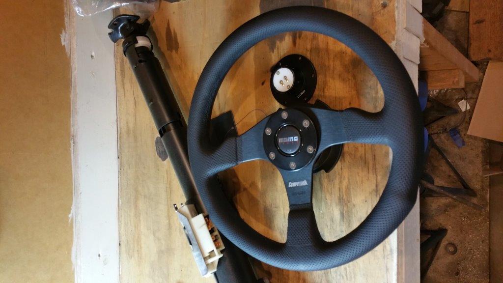

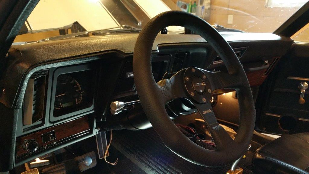

I've been really busy the last few weeks both with work and with my car. I have several things "in process" but have only completed my column and steering wheel.
Anway, I thought I'd post some pictures of ongoing stuff and especially some of my NRG steering wheel quick release so you guys that might be thinking of one can see how much aditional length it adds and what it looks like.
So, without further ado here's some column and steering wheel pictures:

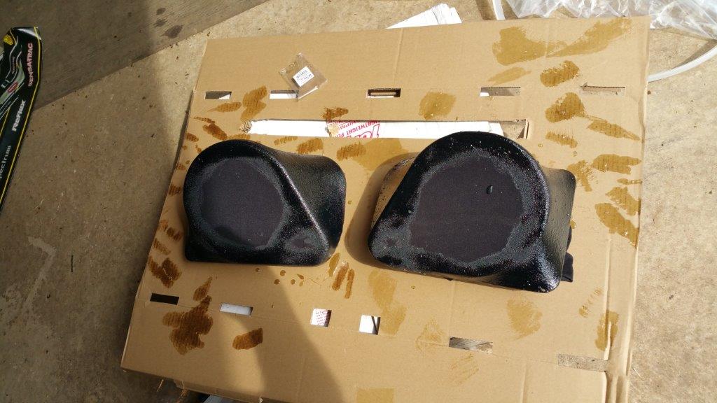

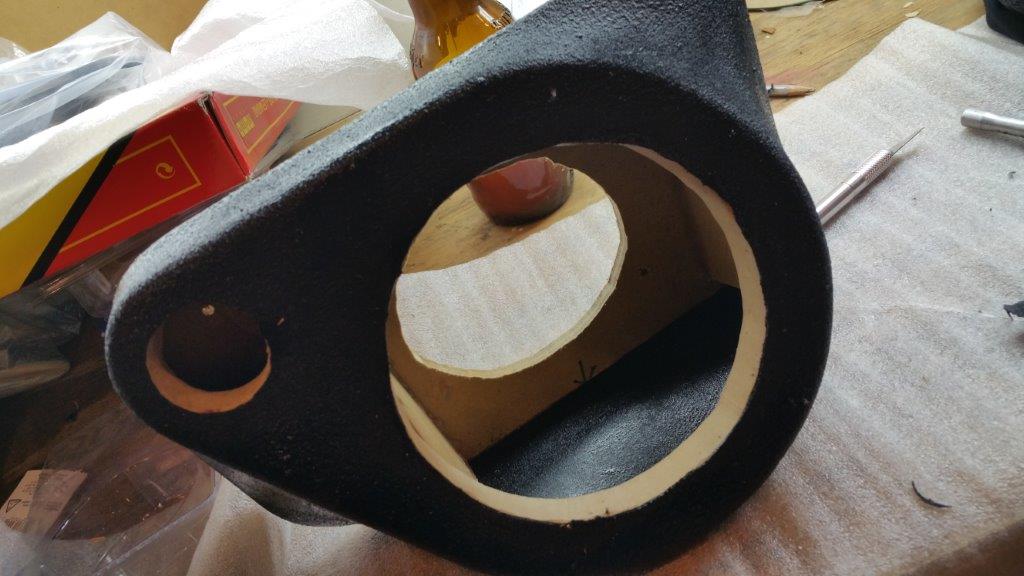

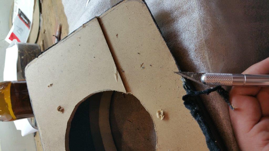

Default Speaker Pods
Next,
I've got some work done on the front door speaker pods.

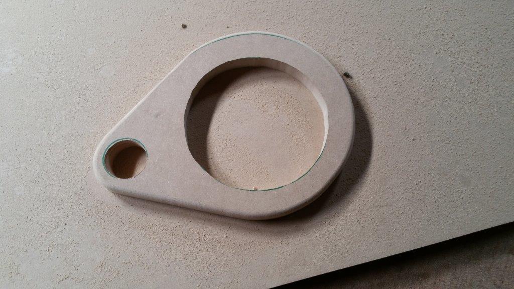

Step 1, make the template form out of 3/4" MDF.
Step 2, make copies of the above form with my POS Home Depot router table and some flush trim bits.
Step 3, attach them to a backing plate with some wedges and hot glue. (sorry, no pix)

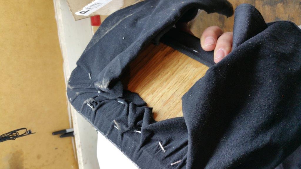

Step 4, get some fleece, two-way stretch, or preferably four-way stretch fabric and stretch it over the form so there are no wrinkes (no wrinkes on the front, you can have as many wrinkles on the back as you want!). You can staple it on the back as shown.
You'll end up up with a very organic looking flowing form as seen below after step 5.
Step 5, fiberglass resin.

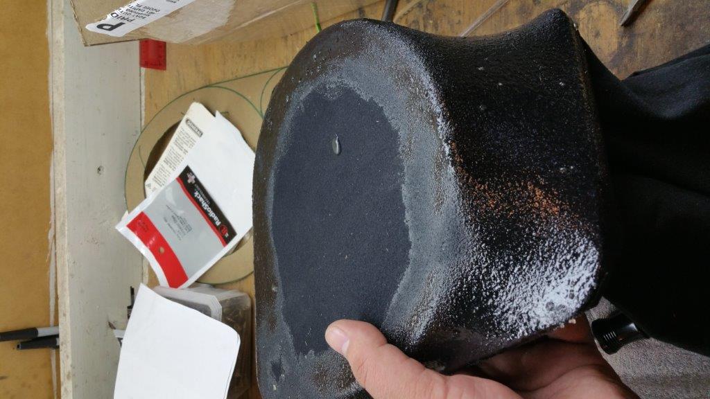

This would be a lot smoother but my old resin decided to set too quickly and get a little thick....
Step 6, trim excess fabric.

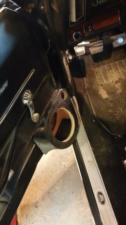

Step 7, admire your -still as not yet completed- speaker pods.
I have a little sanding to do and I may reinforce them with actual fiberglass on the inside later. The general idea though is to cover them with vinyl when they are sufficiently smooth. I think they'll turn out really well and should look like they are made for the car.....afterall, they are.

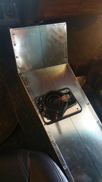

Default Next Up Console
Here's a sneak preview of my super-secret console build.
This is a mockup out of some thin sheet. The basic shape is there but there will be some changes in height off of the floor and places for my double-din, 2 cup holders and a cell phone. I'm also planning on adding charging ports somewhere.
Here is one of the cup holders I'm going to use. It's pretty nice. Stainless steel, two different diameters, and has a cushy bottom. Also, I think they were about $12 a piece, so resonable too.
There's still a lot to be done with the console, but I'm really hoping to get some time to work with it more as soon as my sheet metal guy (my uncle) get's some time again.
