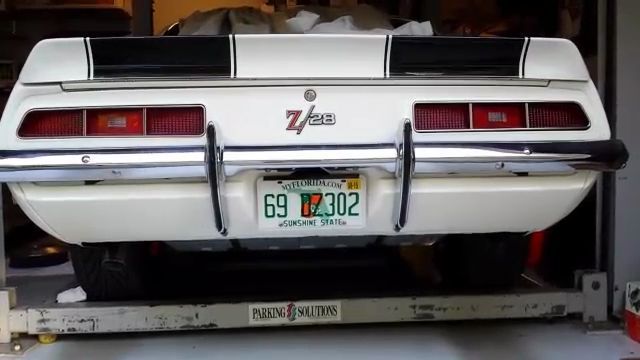

Here's a couple quick cell phone videos of the car warming up. It doesn't do the sound of the car justice. The Spin Tech's are definitely not for the faint of heart.

Here is the cold start idle video.
https://youtu.be/z1JLqpJwVyE

Ya big tease!! Not one stinkin little blip?
LOL. I'll get some more footage soon, but my neighbors needed a break yesterday.

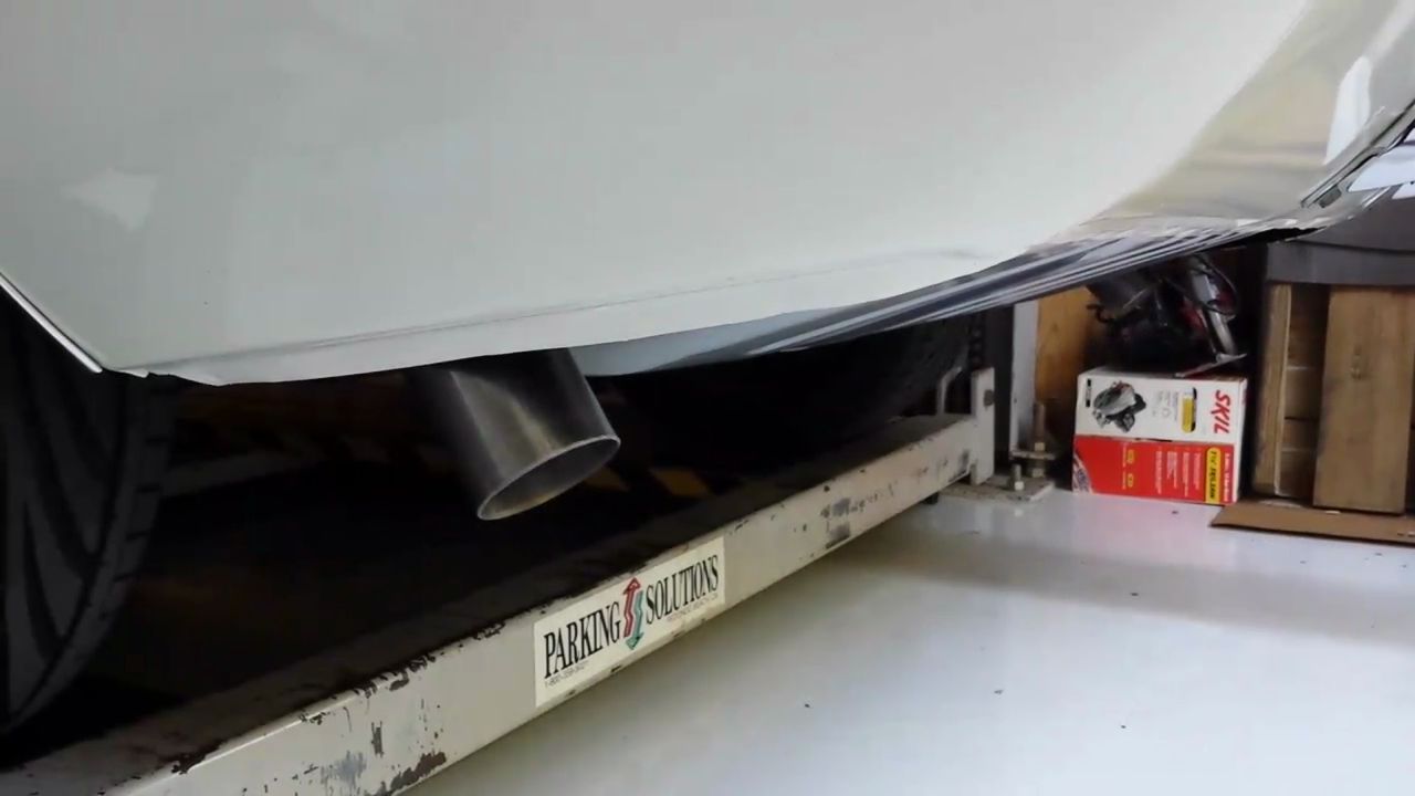

Sounds great! What did you decide about the tailpipes?
I vote for the 45* cut even with the bottom of the quarter...
I'm still not sure. I wanted to get better clearances on the left side tailpipe, so I made a bracket to relocate it a bit. Moving the tailpipe affects the tip angles, so I want to lock down the tailpipe positioning before I cut anything. I park my daily driver under the Camaro on the lift so the tailpipes are front and center every time I come and go from the garage. This would be soooo much easier if I were willing to drill new holes in the car. LOL.

DAUM RITE NEIL, that is pure music, sounds great MY .02 cents on the pipes, Def cut them Need more vids of this thing running out side running OR a drive by????
