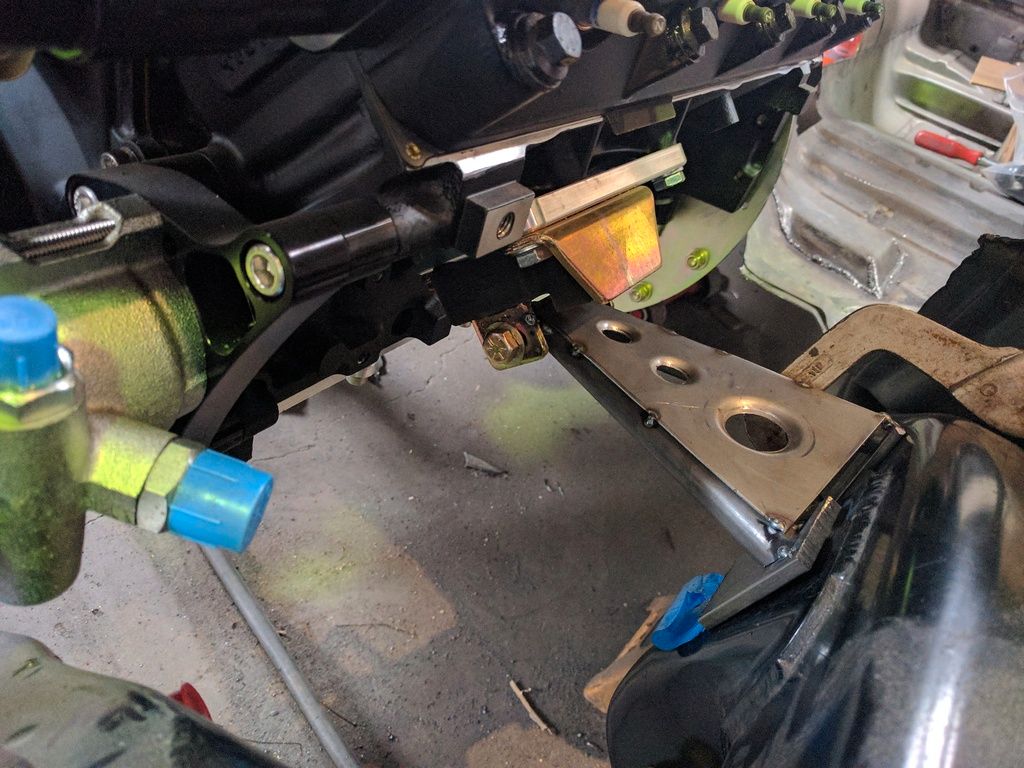

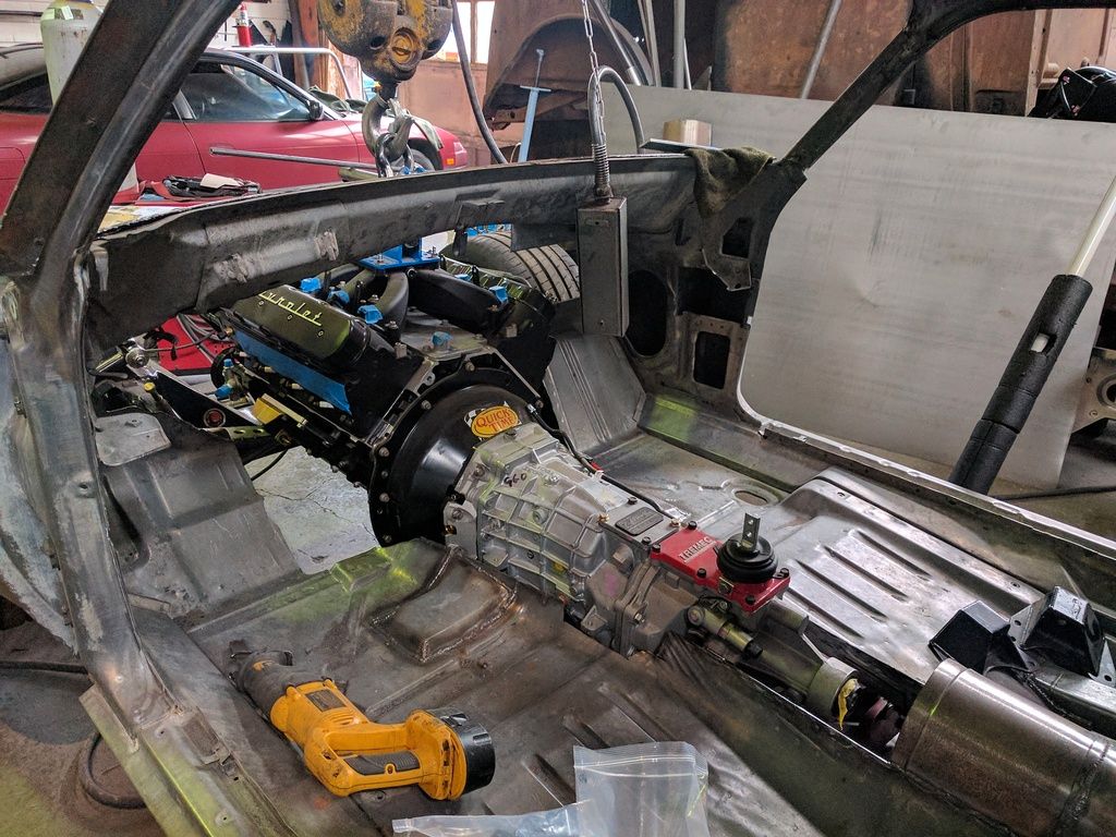

Well, not a ton of progress. The dash is out and the motor mounts have been tacked in but still need a bit of tweaking.
The motor mounts will be easily removable from the frame to aid in engine removal. We will be running crush tubes through the subframe rail and running bolts through the rail from the outside.

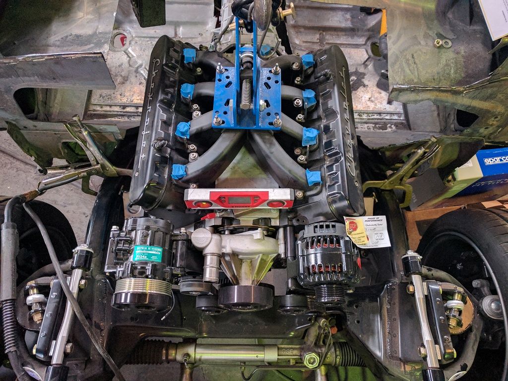

This picture gives a decent idea of where the motor sits in relation to the hub centerlines.

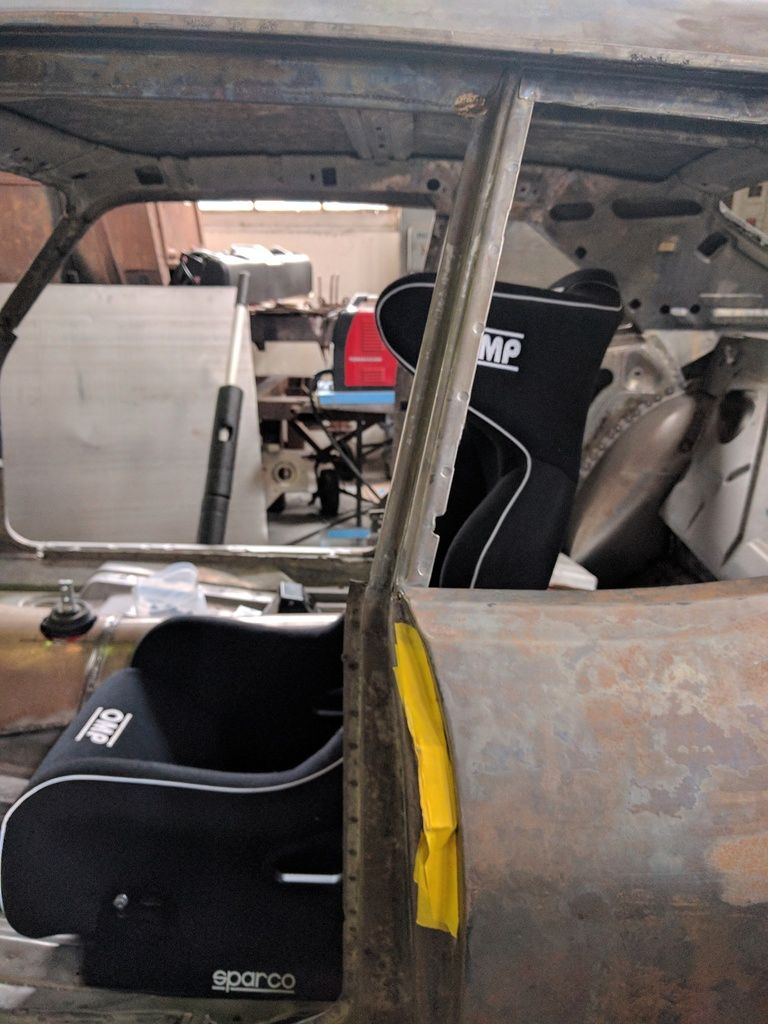

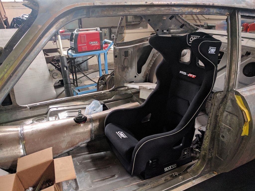

The last thing we did was do a trial fit of seat placement (not my seat). Needless to say, there won't be a back seat

It looks like the motor sits almost completely behind the front control arms. Should help with handling and weight distribution quite a bit!

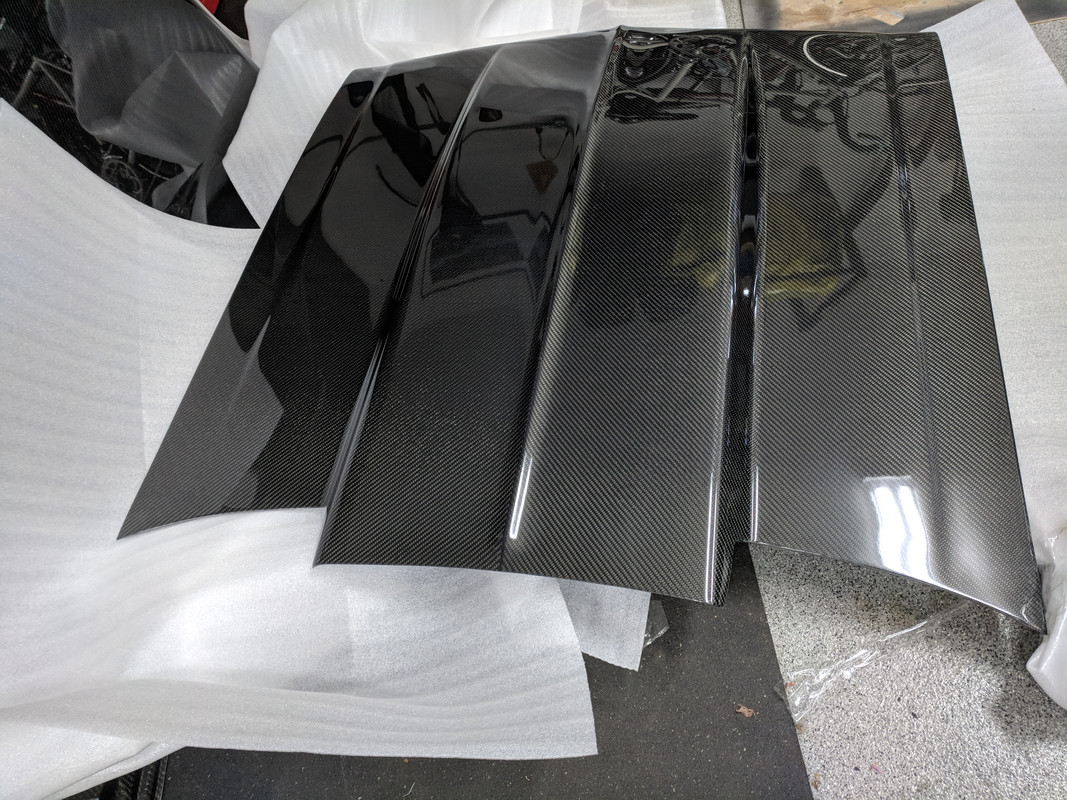

I drove up to Ultra-Carbon and picked up a trunk lid, hood, and cowl panel that I had ordered a while back. The finish on these parts is making it hard for me to want to paint over them...

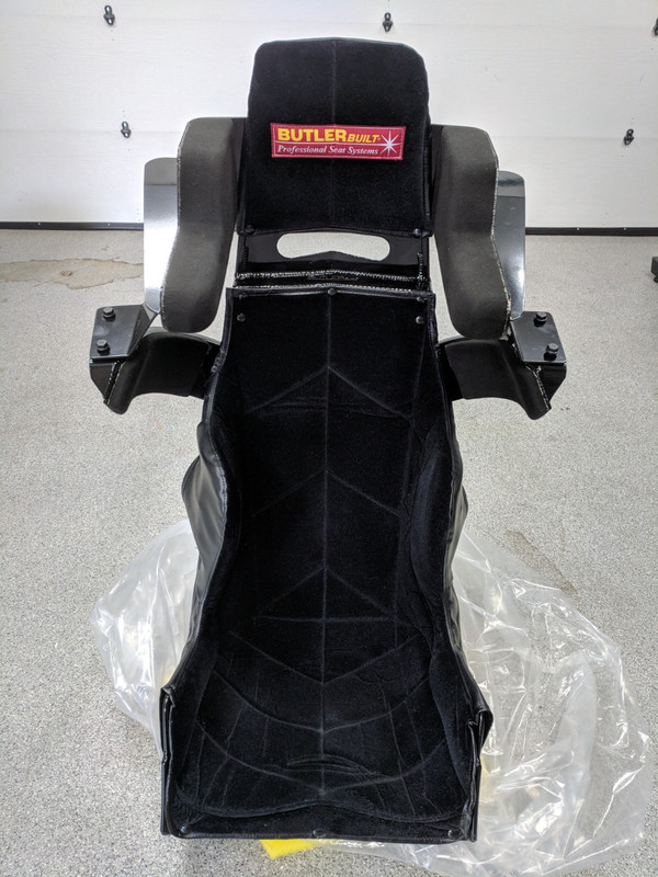

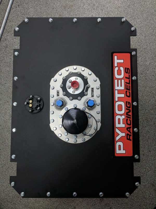

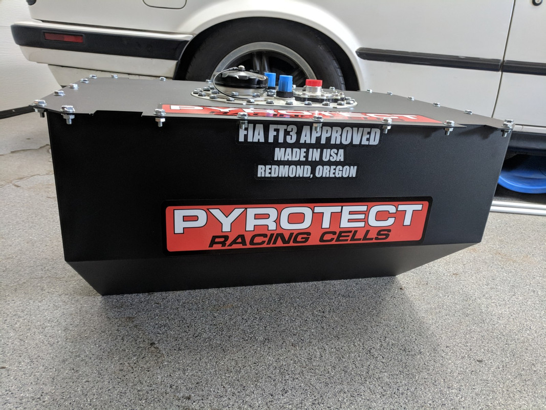

Ordered a 22 gal. Pyrotect cell with an in-tank Weldon pump and a Holley hydramat setup. Working with Steve at Pyrotect was a great experience.

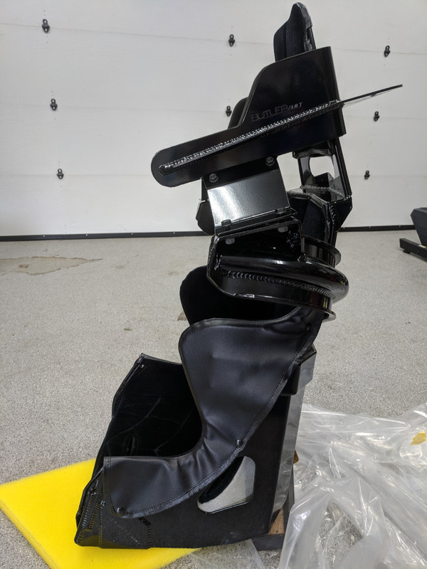

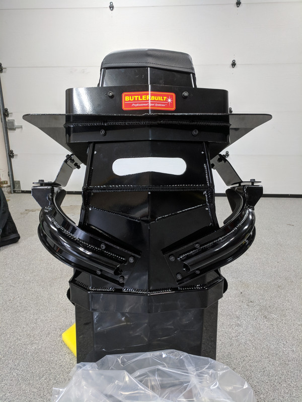

Last but not least, Dave and Mr.Sutton helped me out with getting some seats ordered. The seats are surprisingly comfortable.

Wow, these carbon parts look awesome. I would not paint them

That Carbon man sexy. Do not paint it.
