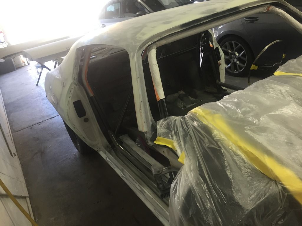

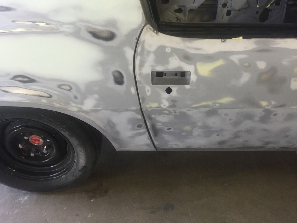

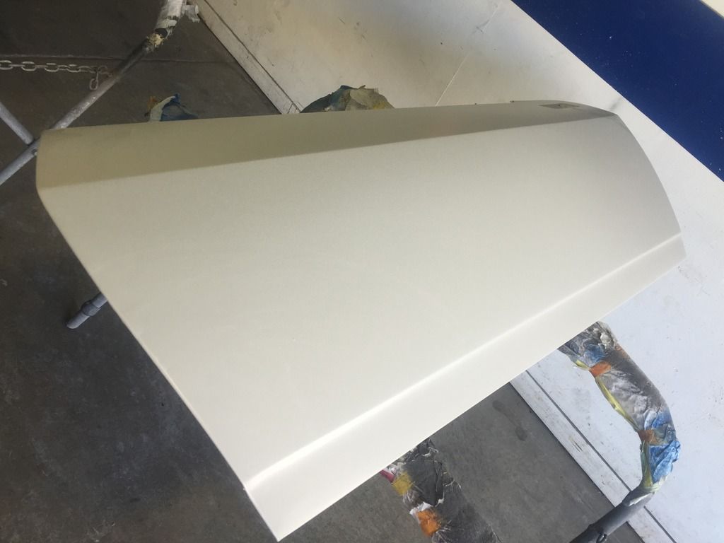

Its been awhile since I posted an update got a bunch of little things done before it went to paint. Got all of the spark plug wires made and tailored. Got the steam port lines bent up and also the pcv. Built the exhaust system ended up doing a full stainless system with an x pipe. It was a trick to get it up and over the axle with the Detroit Speed Quadralink, ended up going with a tanks inc 69 Camaro tank with the notched corners since they do not make one for a 70 Camaro yet, it actually fits good just need to modify the fuel neck a bit. Got the brakes from Tobin at Kore 3 ended up going with the z06 brakes. Also decided to go fuel injected instead of carbureted went with the FiTech efi can't wait to get the car back from paint to get everything on and see how that turns out. Also got the gauges from Speed Hut. The car went off to paint everything is getting final tuned should hopefully be getting color on the car in a couple of weeks. Also got the interior out to the interior guy so hopefully everything should come back around the time the car gets back from paint.
