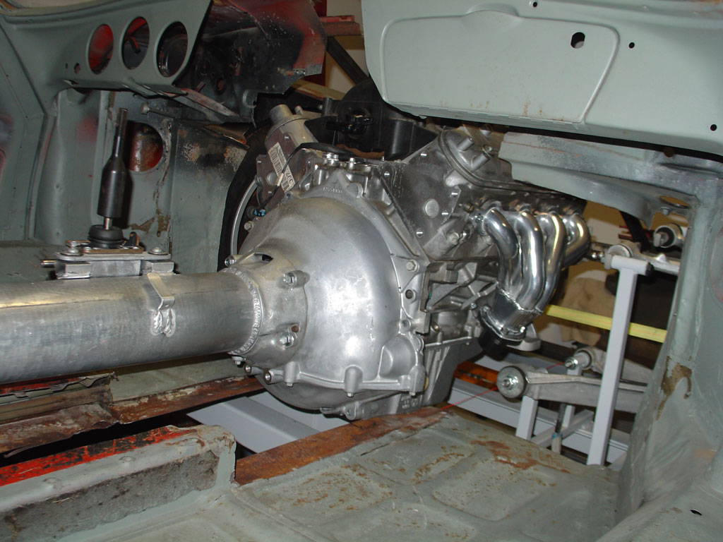

Got some parts this week.
Installed a new Camaro oil pan and put the motor back in. Installed the torque tube and setup the transaxle. 1/2 inch between the axle housing and the right fwd lower a-arm mount. Need to raise the engine an inch. Some final body alignment and it's time to cross brace it and get it attached to the jig.
After much thought, I've decided to do a complete tube frame for the car. Dual tube 1.5 perimeter with the tube center backbone. The cage for the transaxle will be removable. Finishing up the drawings and time to locate the tubing.
Any comments or ideas post away. Thx. Jim

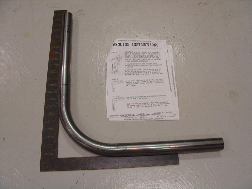

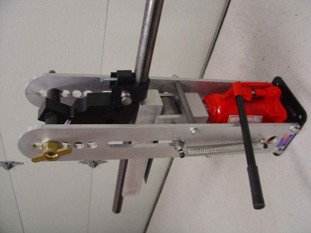

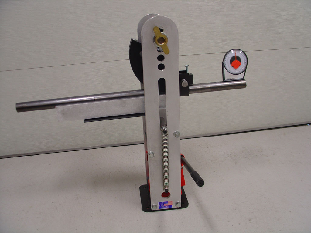

Default Bend something...
Tube bender setup and tuned. Works like a champ ! I got some 11 and 14 gauge EW tube (my DOM .125 won't be in until Monday, bummer) and ran tests to see what kinda bends it could produce. Pretty nice - just a very slight drop on the inside of the bend (about a 16th) but the rest looked good. It takes about 2 minutes to bend a 90 degree. I'll do a test on the .125 to see how that goes - but I don't expect anything different.

what kind of bender is that? looks like a nice simple design.
